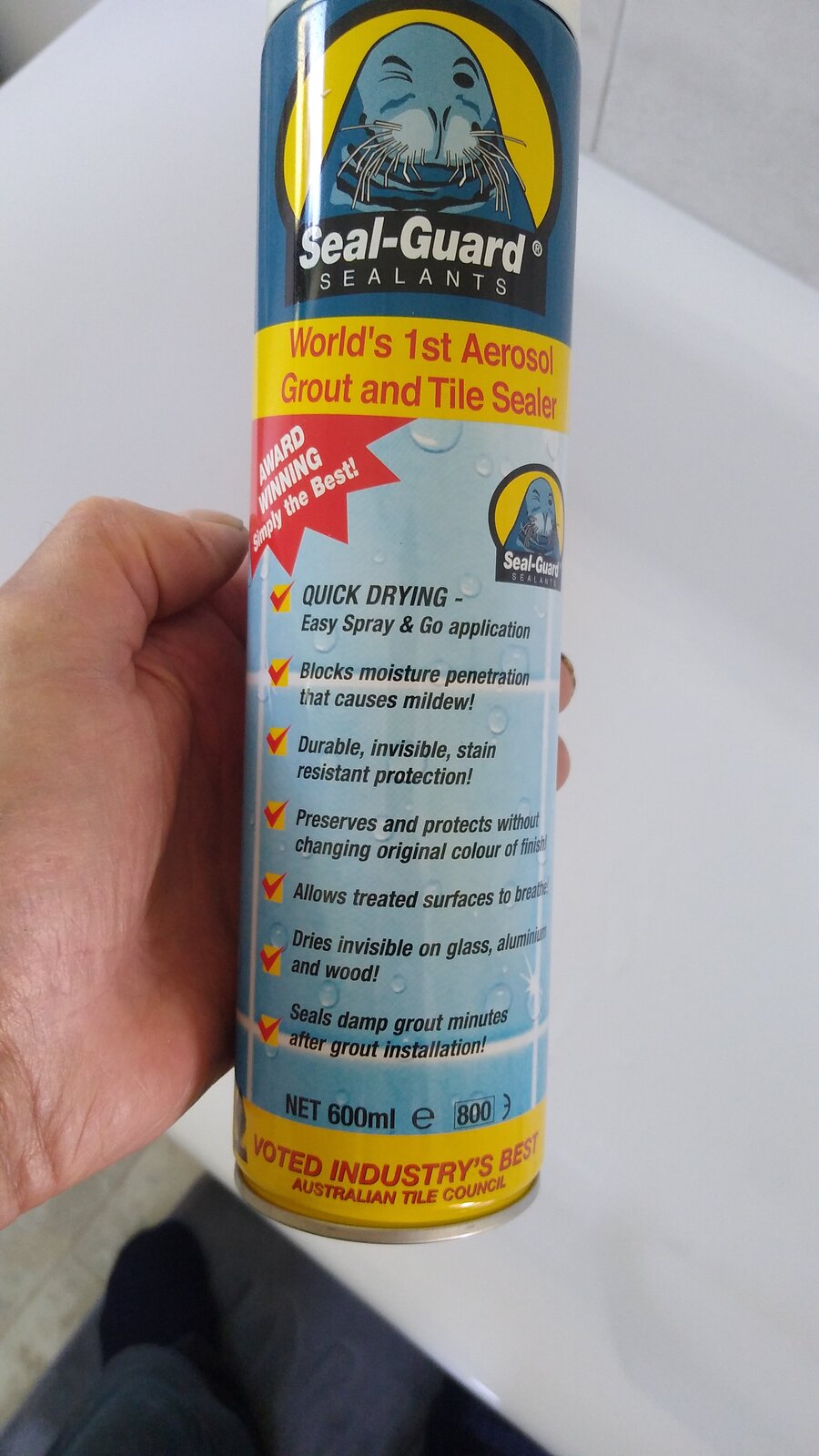

Always used LTP, not the cheapest but has kept my grout mould free for years.
This stuff is superb
