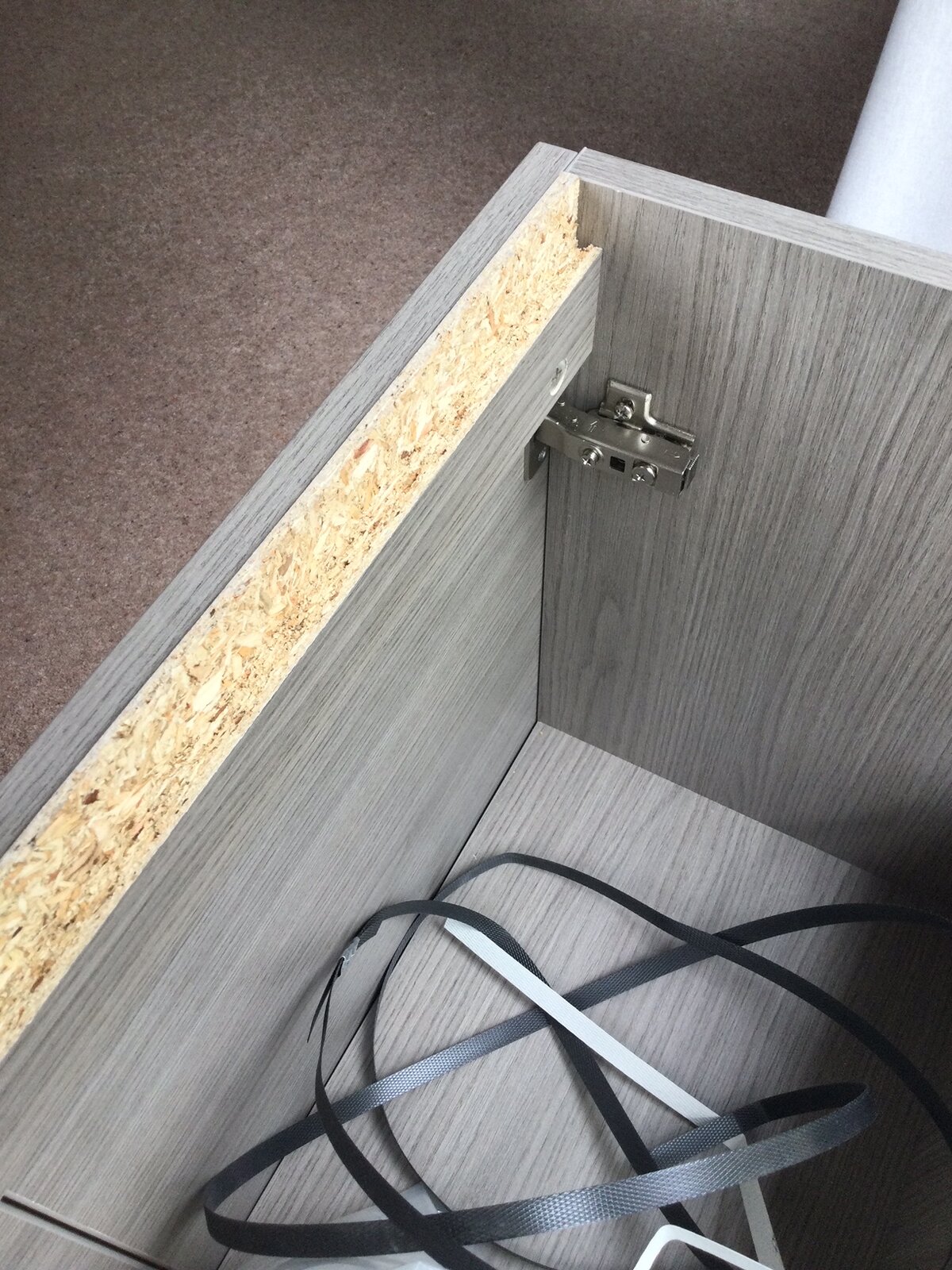

I bought an MFC textured woodgrain vanity unit: https://www.heatandplumb.com/acatalog/n ... t-arn2505d
Our bathroom has high humidity and no extractor.
I doubt very much that this vanity will make it through the winter without sealing - I have no idea what to seal it with. Also, I will be buying a dehumidifier to offset the lack of extractor fan.
I have leftover Zinsser Perma-White satin (that I used on the bathroom ceiling) that I could use on the exposed chipboard (see picture), but I was hoping that I could use some kind of clear varnish or sealer on the woodgrain effect melamine to help protect further against moisture/humidity and prevent the vanity from blowing/warping/deforming. Help!

Exposed chipboard edges absolutely need to be thoroughly sealed with an impervious material. I'd suggest a good coat of silicone sealant or 2 to 3 coats of oil-based gloss paint or varnish in areas that can't be seen. Forget about water-based anything, though, regardless of brand or price - water is the great enemy.
Don't bother with the melamine. The melamine is a waterproof thermosetting plastic with a very amooth surface and will probably be more durable than any coating you can apply. In any case, I suspect that many lacquers will either not adhere to it or will bubble off; it's worth noting that when overpainting kitchens (which have MFC carcasses) it is essential to sand the surfaces before painting in order to provide a mechanical key for any coating. If you don't sand it the coating tends to peel or bubble off prematurely
Thanks for taking the time to reply JobAndKnock. According to the manufacturer, the exposed chipboard has already been sealed:
From that link, it states "Any exposed carcass components have been treated to prevent any water ingress"
I agree, I'll have difficulty getting any kind of adhesion to the malamine. I'll leave that alone. Fingers crossed the unit lasts a few years!
A dehumidifier won’t cope with the rate moisture is produced in a bathroom, you need an extractor fan also cheaper to buy and run than dehumidifier.Better to solve a problem than try to accommodate it.
