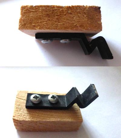

I have a P shaped bath and the side panel has never been very secure. Recently one of the little clips fell off. It had been glued onto the underside of the bath rim. Can someone tell me what type of glue I should use to put this back on? Also where would I get another couple of these clips?
I wouls use a blob of silicone and wedge the block in place with a bit of batten overnight till it goes off. Only way to get more clips I would think is speak nicely to the bath makers say pretty please and with luck they would pop some in an envelope to you.
Otherwise look at cobbling something else to together perhaps with self adhesive velcro pads.
