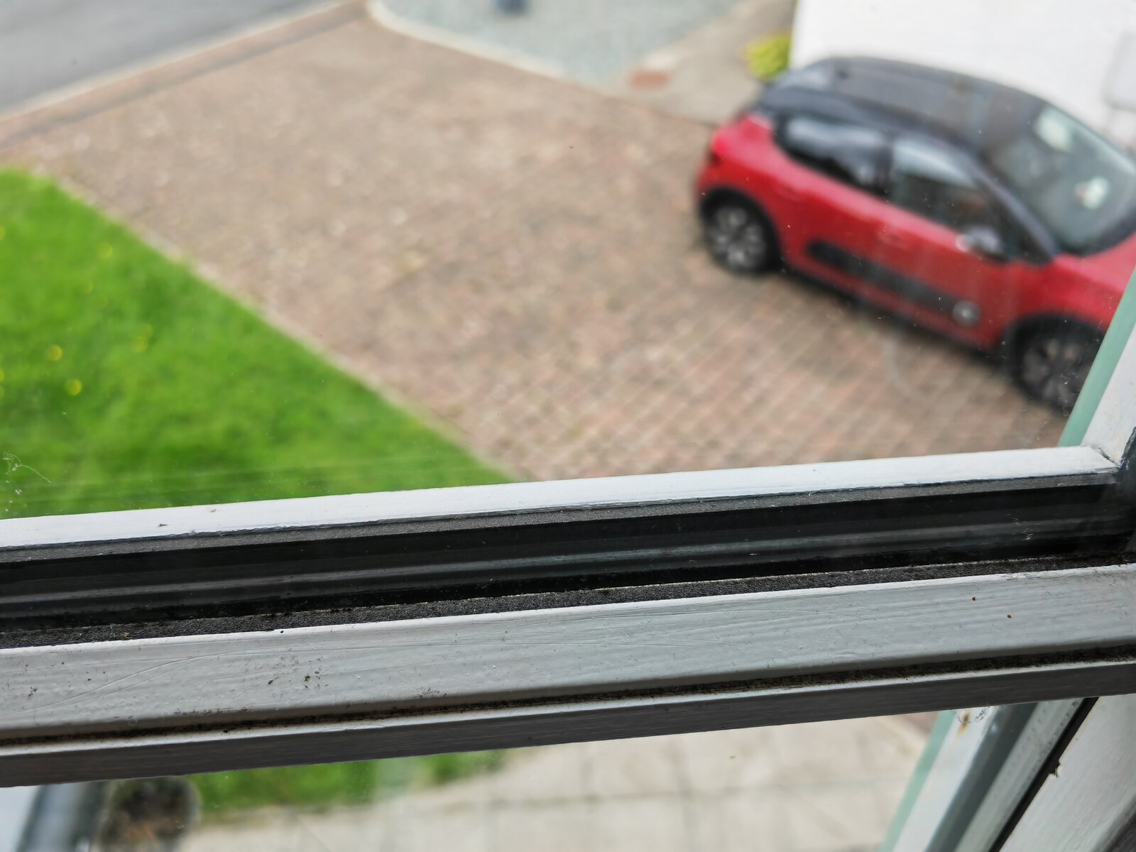

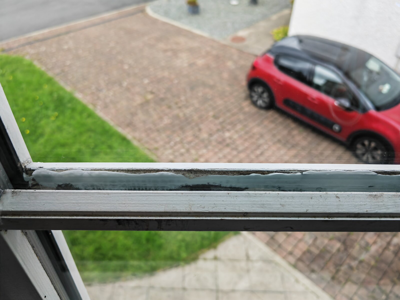

The window has wooden strips across the centre that divide it into two sections. On all the original windows, these strips were stuck and sealed with a thick black tape-like material that looked neat and professional. This time, however, they skipped the seal entirely and stuck the strips of wood directly onto the glass using some white substance, possibly sealant, putty, or paste. It’s uneven, messy, and clearly visible through the glass. It looks like a rushed job, and I’m worried it might not be good in the long run.
I’ve always understood that certain sealants or compounds shouldn’t be applied directly to double glazing, as they can compromise the integrity of the unit. Am I right to be concerned? I've attached 2 pictures one of the window they did yesterday with white stuff the other is what all other windows look like. Does this look and sound like poor workmanship?

Looks like the original was fitted with a double sided security tape , the replacement looks very much like white silicone but possibly CT1
Unless the 'silicone/ct1 ' comes into contact with the sealed units black butyl sealant then it will do no harm to the unit and just looks really messy
