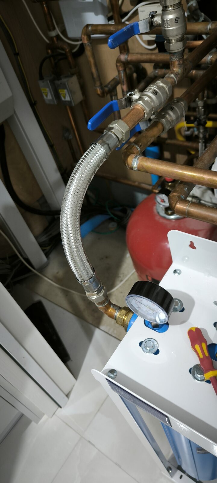

Hello everyone,
I have a water filter and water softener and would like to connect them to the rigid pipework which is 22mm and 28mm with flexible tap connectors. The ones I already have here have a small internal diameter, about 13mm. I am looking for something better, if it exists?

Thanks. I found in my storage some short flexi tubes but with large diameter and have used these. I did not use the flexi tap connectors. I do not know what the ones I have used really are for :-)
Most standard 22mm-3/4" flexi's are around 13mm ID, largest I've ever seen is 15mm but they were supplied with the tap. 28mm aren't widely available either.
This is the flexible pipe I used. (the copper pipes are 22mm)
