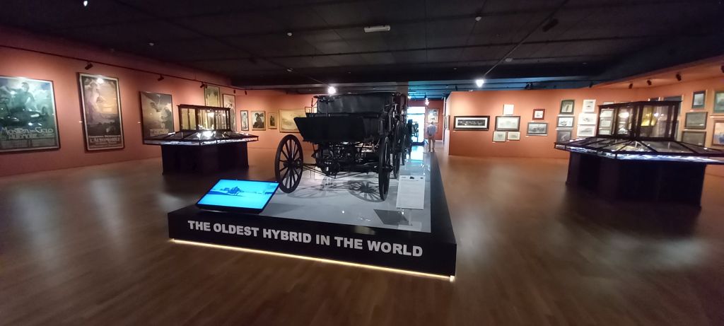

Incidentally, they're older than you'd think! This thing, in 1896, was a parallel hybrid AND had regenerative braking!
