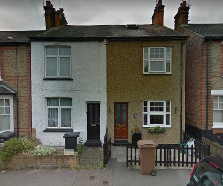

This was my first house - the white one. Semi-detached, the gap on the side was a few inches I think!
Never heard a sound from the left, but loads of noise from the 3 kids on the right!
I would guess that is just a single brick wall between the two halves, hence the noise. Is that a back to back? I think I can see 4x chimney pots, which seems excessive for a 'through' house? If so it is smaller than the two up, two down I was born in.
there was a chimney in the front room and back room, which I guess was the kitchen originally. Kitchen extension on the back later.
Upstairs bedrooms had fireplaces too. I think. Main was removed, but I think 2nd bedroom still had the fireplace... can't really remember now.
Stairs went up across the house, starting on the outside wall, so landing also on attached wall - that was where the sound came from, mostly the kids running up and down the long landing!
