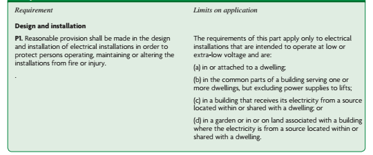

There is no 2.2a(ii) of Part P.
You are referring to Approved Document P which is merely a guide someone has written, the only statutory parts being those in shaded green.
Approved Document P does, however, quote on page 2 the actual Building Regulation Part P in its entirety:
That's it; there is no more.
Your interpretation of it is as valid as anyone else's.
