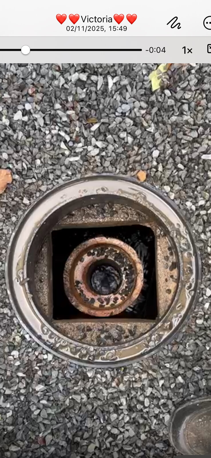

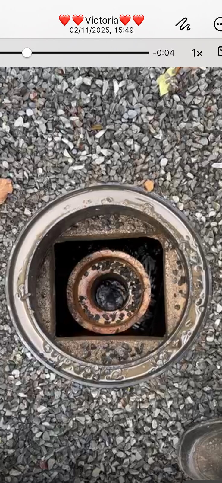

Hello all,
I am thinking about buying a house with a septic tank. Never owned one before.
I think I’ve found the cover for it, I’m doing an unescorted house viewing so have a good chance to snoop around.
Anyway, here is a picture. It shows a red clay pipe and there is a constant flow of water coming out and into the tank.
Is this normal?

Flow rate into tank = flow rate out . Only time flow goes into tank should be when foul flow occurs from property i.e toilet/sink/bath/shower. Sounds as if there is ground water infiltration in to feed pipes and bottom of pipe blocked up due to septic tank not being emptied for a very long time.

First off is this the actual septic tank? I know it’s hard to tell from one picture. I can send a video but this forum won’t let me post a video.
Second, yes in my mind I would have thought the only water entering a tank would be when the house was getting rid of foul water so was surprised to see this.
I’m going to say no.
In that case, I’m going to isolate the water to the house and see if it stops. If it stops, then this means water is somehow flowing from the house into the inlet pipe. Either passing toilet , toilets , or maybe a flat valve on the cold water tank being stuck and water going down the overflow.
Or
Rain water /ground water getting into the pipe. In my mind, this can only happen if the pipe is broken .
Would you say the above is correct?

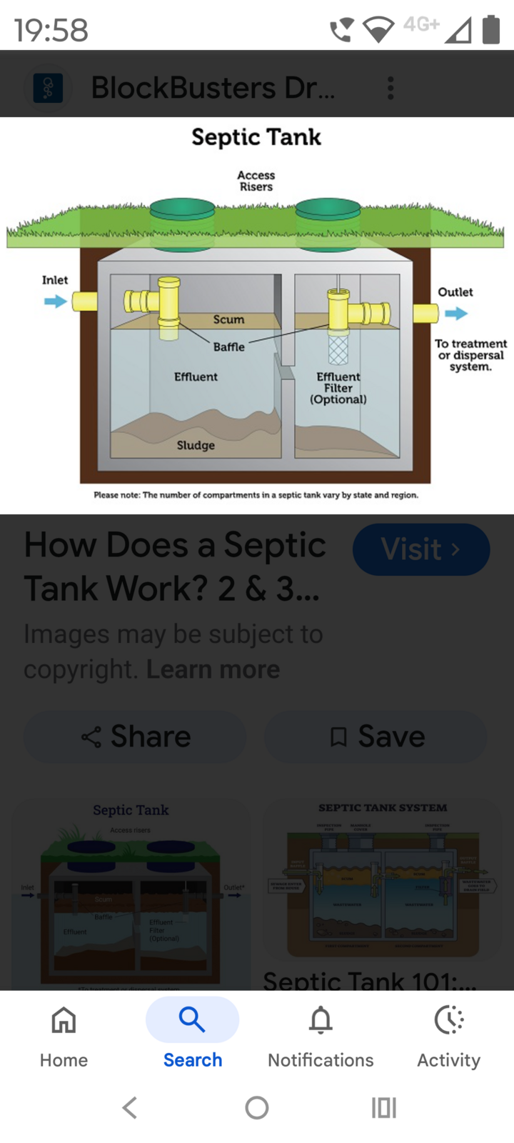

Various types and sizes have been built or installed over the years, from the early brick built type to the later 'Onion' shaped Glass fibre offerings from Klargester etc. All work on the same principle, raw sewage comes in, the solids are allowed to settle out, and the clarified effluent is discharged either into a leachfield/soakaway, or in some cases a nearby ditch or watercourse. However the Legal position for Septic Tank Owners has changed in recent years, and it may be wise to read up on the rules as if your installation isn't compliant, getting it so can become very expensive, very quickly!

So, I turned off the water to the house. Waited for about 45 mins and went ti check. Water still flowing as per my video above.
It hasn’t rained for 2 days here in scotland , so would be amazed if it’s still ground water , either way, whatever it is, it’s not good for the tank, that much I have learned.
So it seems there is a bigger issue at play here, bigger being more expensive.

This was running even when there had been no rain for well over 2 days. Just constant water running in as per the video. To me doesn’t seem right but maybe it is.
Could be groundwater, how high is the Water Table, what's the surrounding soil, number of variables that need taking into account. My area is heavy clay soils, number of tanks I've been to where the Soakaway was actually working in reverse, draining the surrounding soil back into the tank.
Tanks were permanently full, drainage was backing up to the property, arrived with the Tanker to start emptying the Septic Tank and as the level dropped, the flow could be seen/heard coming back in the outlet. Lot of the Villages struggled for many years, some now have gone onto a First Time mains sewerage scheme, which thankfully has alleviated their issues.
Issue will be for you, is the tank coping/will the tank cope? If the property is currently unoccupied it may be happily ticking over, arrival of people and additional foul flow into the tank may then become an issue.
Ball Park Figure for treatment plant? £4K? Again, many variables, access, ground conditions, soakaway requirement, will need a suitable power supply, etc. That many not solve the issue of the water ingress, best option for that, if groundwater, may likely be to either replace or line the pipework from property to the tank. Again, depending on depth, ground conditions etc will factor in the cost.
