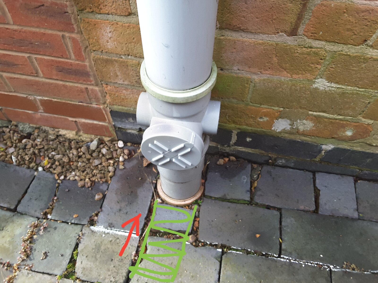

Hello. I am thinking of the ACO-drain installation. Here is a photo of the sewage pipe. This is exactly where the channel drain is planning to discharge. Would it be safe to dig around the pipe to see how far under the ground it joins the main pipe? Is there a chance that underground I will find an inspection chamber? Thanks

Firstly, rainwater shouldn't be going into a Foul Sewer unless you've exhausted all other possibilities for disposal. i.e. Soakaway, Surface water drain. Where does the rainwater go from the property?
Inspection Chamber covers should be clearly visible, only a fool buries them.
