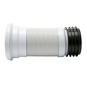

From what I can tell all the traps are working ok, the only thing I suspect is that the toilet isn't fitted properly and the gasses may be leaking in from the flexible pipe as its not sealed properly. The one fitted is similar to the one in the picture attached, but it doesn't seem to have many of the sealing fins (don't know the proper term, but they are black on this picture) and I don't think any actually sit inside the soil pipe. They are just pushed up against it.
Could this be the problem??

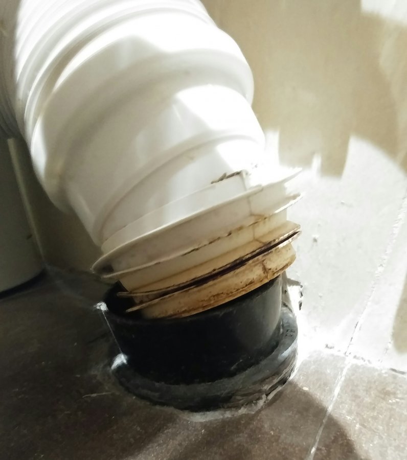

So tested as per Madrab suggested but with a candle, we're right out of incense sticks!
Soon as the loo was flushed the flame was sucked in towards the joint. So I'm thinking that flexible connector has seen better days. I also noticed that there was some silicone at the joint round the back of the loo, so someone may have tried to resolve this problem before.
I've put a picture of the connector on here. It all appears to be plastic that fits into the waste, no rubber and the plastic is fair rigid.
Plan of action is to replace this and see if that cures the problem.

That pan connector..... is not connected.
Needs pushing into the soil so you cant see any rubber fins
Hi Nortonj, I pulled it out to show the fins. There seem to be very few to all the ones I've seen at plumbers merchants
A
Ah ok. Depends on the brand re the fins but looks about right to me regarding the amount, but yes its seen better days. I would replace
Yup, cheap connector with rubbish seals by the looks of it, get a McAlpine, gloves on, clean inside the pipe, then a bit of lubrication on the seal and push all the way home until the last fin is inside the pipe, clean the toilet pan spigot till squeaky clean, then connect to toilet.
