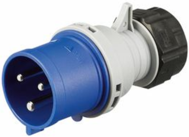

Ok, as it looks like it can be done the way I was suggesting, what would I need to buy for the electrian. I.e size of trip for house cu, type and size of cable to outside socket and of course best 32 amp socket?
Nothing, as he'll be able to get it cheaper.
Those must all be decided by your electrician.
I being the person responsible for the design, construction, inspection & testing of the electrical installation (as indicated by my signature below), particulars of which are described above, having exercised reasonable skill and care when carrying out the design, construction, inspection & testing hereby CERTIFY that the said work for which I have been responsible is to the best of my knowledge and belief in accordance with BS 7671:2008, amended to 2015 except for the departures, if any, detailed as follows:​
One which complies with 553.1.201

In that case speak with the electrician for a list of parts, chances are (S)he will have a preference and will not appreciate being given a pile of bits to do the job with.
