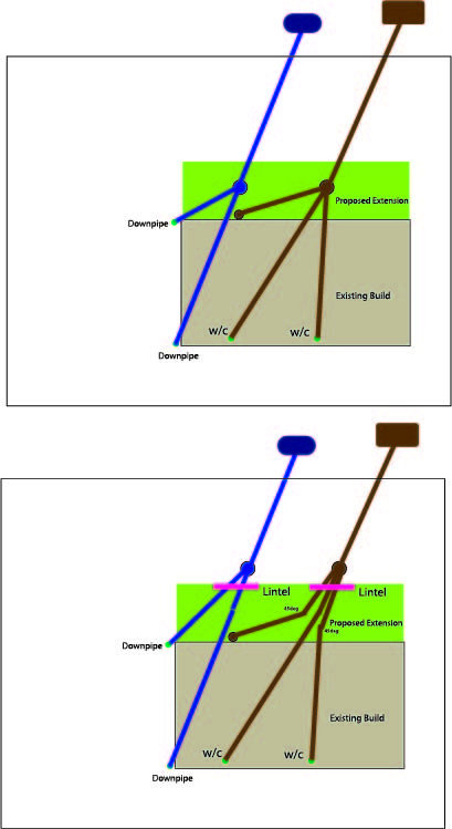

We are buying a house and plan to add a rear extension. Went to view today to measure up and check for drains. The Foul and surface inspection chambers are right where the extension is going to go.
qu.1. I don't want to have to have access to inspection chambers in the extension (tiled kitchen floor) so I plan to relocate, what is the best way. I wondered if I could 45 degree and extend all pipes out the footing under a lintel and make a new chamber in the garden (see image). Is this OK, or is there a better way?
qu2. The surface water looks about 550mm below DPC level, but the foul looks very shallow, approx. 400mm below DPC. I was wondering how this would work with my concrete floor? As far as I can understand the regs, with 60mm insulation, the floor will be 400mm min thickness. If there a minimum distance below hardcore that the pipes can sit? or can they be touching, or within the hardcore layer (obviously protected with finer material).
Many thanks

Q1. I've been lead to believe this is a no-no now, your not allowed to have chambers in the footprint of your structure anymore thus it will need to be moved. Albeit someone on here may have a better understanding than me.
If your moving the pipe work you 'may need to renew the length of foul pipe that runs across your property so that you can tap back into it at a more convenient point. I renewed the complete length of mine for obvious reasons.
You will also need to inform/apply to you local water company for 'permission' to 'alter' any pipe work 'they' own & once done have a survey of it to make sure it's fit for purpose and 'complies with their regulations
2. I'm not 100% of the depths of ours but are you talking about the pipes 'from' the property and not the ones they actually run in to?
Any pipe work will need to be covered completely with pea gravel then hardcore.

I can't see a lot wrong with your proposals other than you will need to keep the drain runs straight where you are able. If you do need a change of direction do it with a slow bend.
You can have manholes within buildings.
If you can provide rodding access elsewhere, you can seal the manhole up

r1flyguy - great pictures of your project! Luckily The pipes are all private and cater only for the detached house (as far as I can tell) and only enter the adopted public sewer chamber outside the boundary, so we are free to modify as we wish and just need building regs signoff rather than water board approval. I would rather move the inspection chambers outside the extension anyway, we will have a tiled floor in the extension so cannot cater for a chamber.
The depth I was referring to is the current depth of the services at the current inspection chamber just outside the current house (top image) , but in the centre of the proposed extension.
noseall - I am still working my way through all the reg documents, but ive heard a few places that you are allowed up to 45 degrees bends that are not serviceable, is that right? Are slow bends available in anything other than 90 degrees? I plan to cut the current pipes at a suitable location and 45 degree bend them using new pipes and fittings out of the extension through a lintel in the foundation. The pipes are 30 years old, so I assume they are compatible with current plastic pipes.
woody - the 2 soil pipes in the images are from WC stacks, so I don't think we will struggle to be able to rod them at source? I cant remember seeing any exposed stack with rodding points.
Great news on your waste being private, saves so much hassle that's for sure.
You can by slow bends no problem, also most connectors from clay to plastic too if you have clay.
You can also by a curved 110mm pipe and just cut the angles you require at the join and use a rubber flexi join if needs be unless your smack on with your angles.
