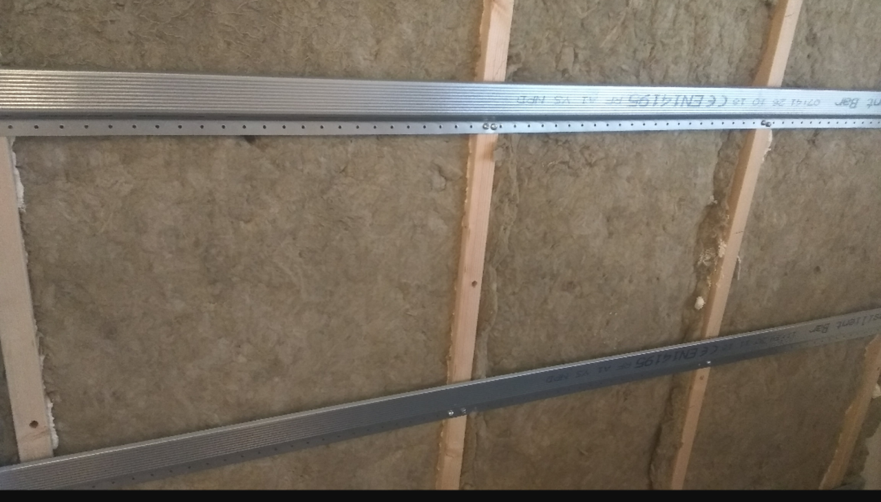

Wayners Joined 24 Oct 2020 Messages 5,970 Reaction score 2,170 Country Today at 9:32 AM #17 Timber screwed to bricks Acoustic insulation Resilient bar Now double plasterboard screwing boards to bars. It's not cheap although easy enough. Take some doing for the complete adjoining wall and about 130mm thick. That's 5 inches
StephenStephen Joined 1 Apr 2008 Messages 1,748 Reaction score 359 Location Devon Country Today at 9:44 AM #18 Could the sound be travelling through the void under the floor?
