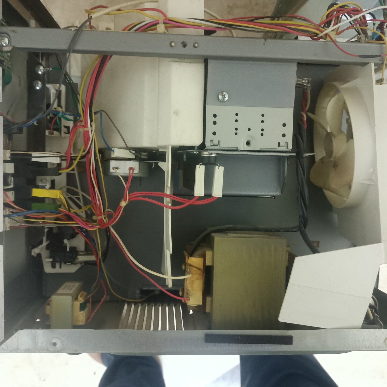

Hi oven is working but food is not heating up,i opened it, physically nothing wrong,kindly help

When you say "not working" do you mean you can hear the fan running but there is no heat? I had that experience recently and the heating element had failed. Quite simple to change by an electrician or anyone with electrical experience. I was a bit confused by the photo though...
Yes, I was also confused, a big transformer like that suggests microwave...
Google lens has the answer and pointed straight back to this forum!
https://www.diynot.com/diy/threads/sharp-r959slmaa-combination-oven-dead-or-not.490417/
It is a combination microwave.
And OP, you really shouldn't be messing around with the inards of microwaves if you don't know what you are doing - the charged capacitors can kill :(
I totally agree. I once had to replace the fuse in mine and I remember following the instructions to safely discharge the capacitor very carefully indeed.
All wiring faultless, components seems okay but I think that magnetron may be faulty but if i go to purchase new magnetron i will prefer to buy new oven.
