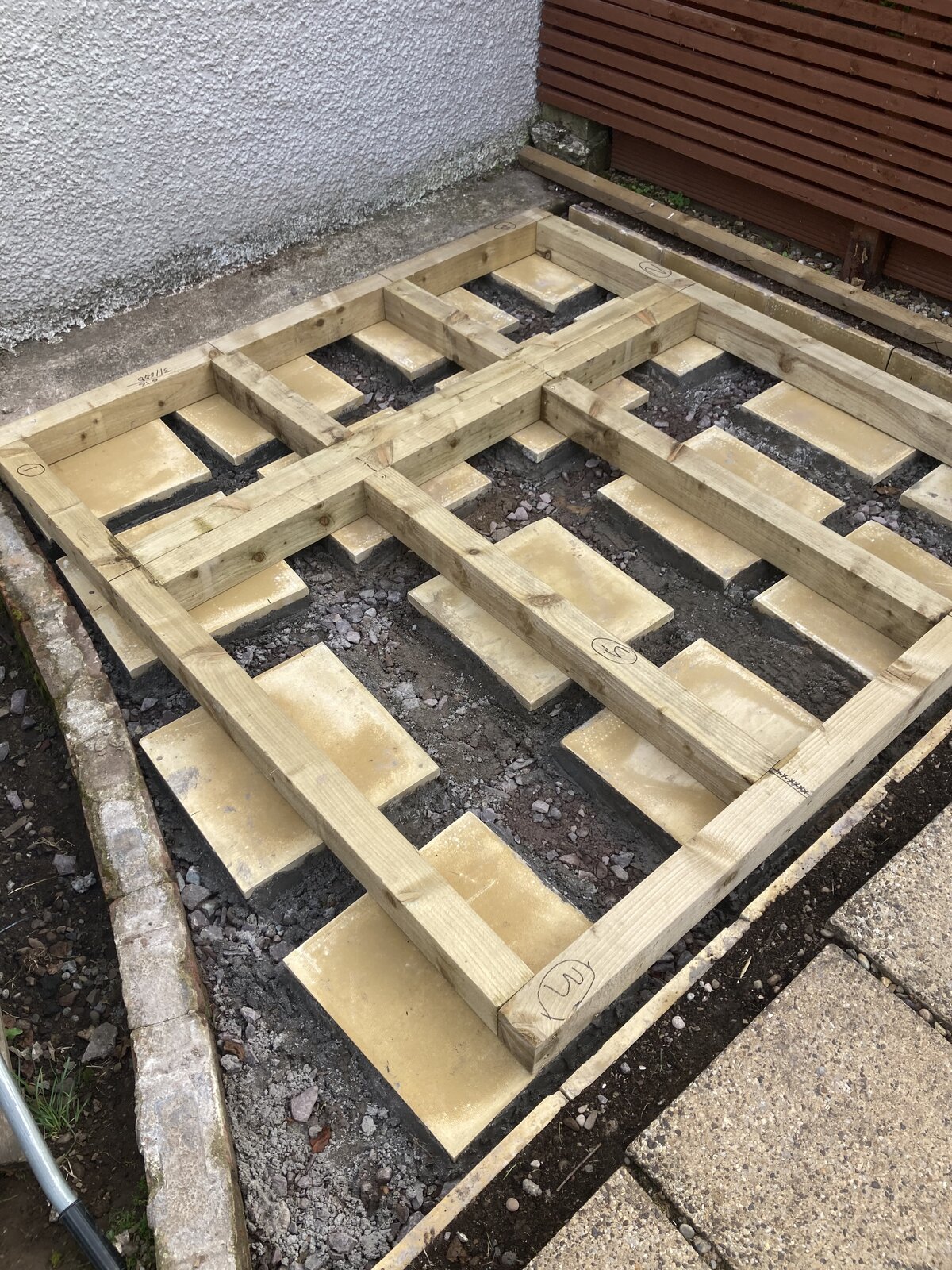

This is the base I made for my shed last week. It’s 3x4 posts, on top of slabs.
Slabs on full bed of aprox 50mm thick cement, on top of 6” of type1
