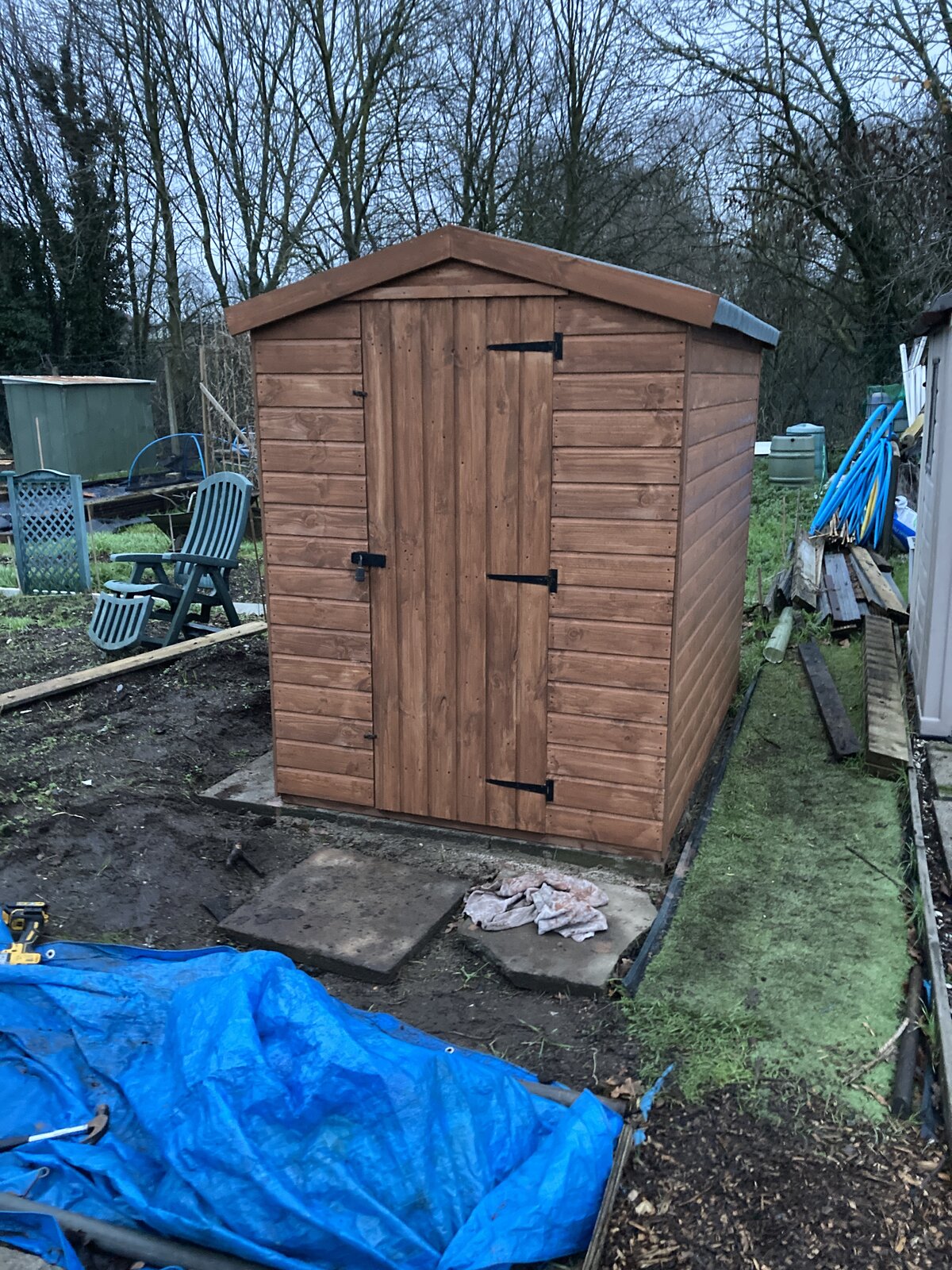

The shed I've just got for my allotment was laid on paving stones with no more than a 2"-3" bed of dry sharp sand and cement mixture. I think I used three quarters of a bag of cement to 8 bags of sand.

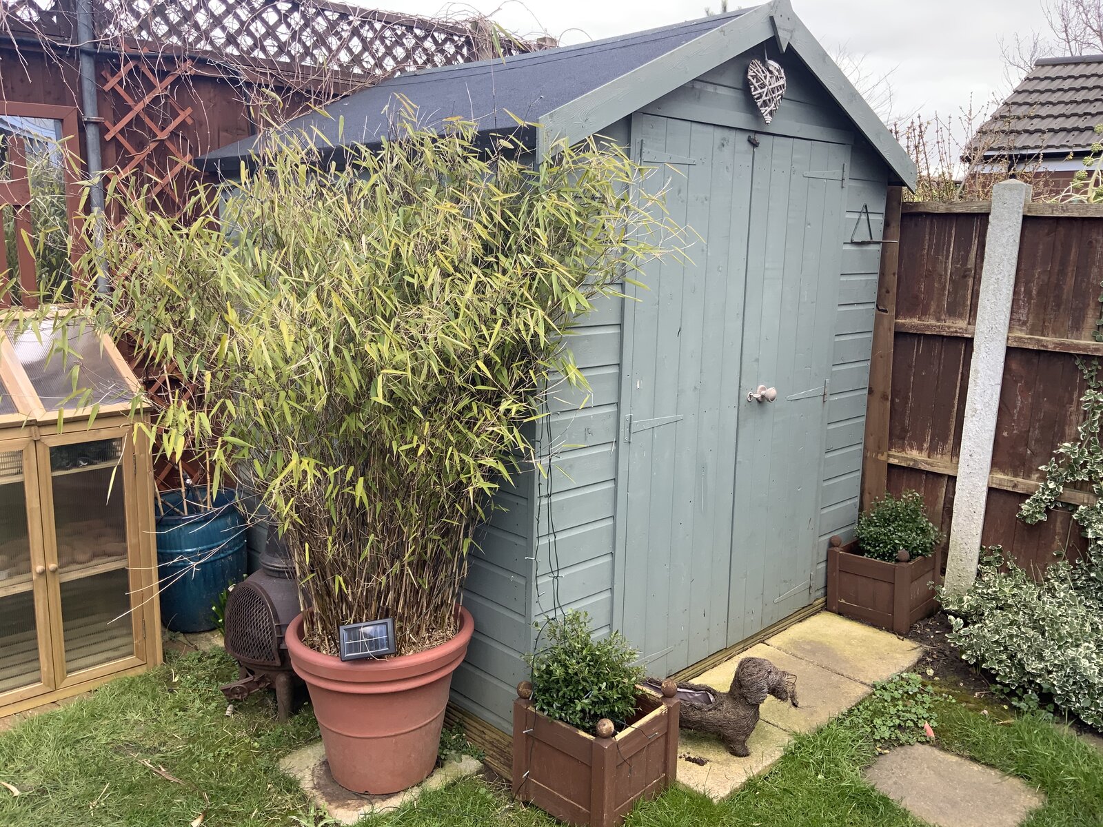

The shed I have in my garden was laid on patio stones with just a 3" bed of soft sand underneath and it's been fine since being put there about 6/7 years ago.
