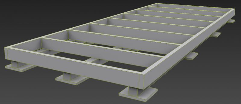

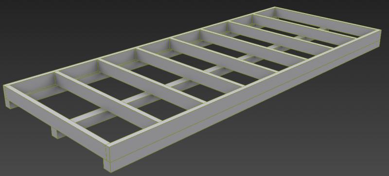

Base
Overall, 16ftx6ft
4x4 skids - I'll be placing these on top of 9 or so flag stones as my base as I can't concrete the garden.
2x6 joists on top of that - Why do people let the joists overhand the skids? I've seen it in many examples but I don't quite understand if there's any technical reason for it. Maybe so there's less chance of them to slip off, seems a bit farfetched, so I've put my joists to the edge of the skids in the plans.

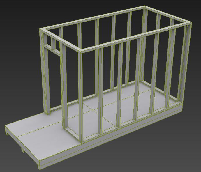

Walls
2x4 for the framing. I'm thinking of putting a window on the front side but I'm going to have to look up how to do the actual window frame for that because I have no idea.
The shed part will be 12ftx6ft as I want a side door instead of a front one. Looking to put a bike store and small greenhouse up against the front. It'll be more obvious where in this next photo.
I've read that horizontal beams are only required so cladding has a good number of places to attach to, is this true? Because I'd be happy just attaching to the verticals.

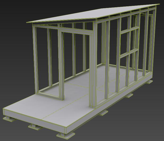

That's how far I've got so far, just the basics I know, but I want to get this right. :P As you can see I want a small area on the left as a sort of porch but I'll need to think about the roofing as ideally I think I want it covered. Any ideas on this I'd be grateful.

I used osb with 3X2 frame attached, reduces timber required, increases strength, reduces build time and gives unbroken surface to clad.
Overhang is so rain runs of walls at edge and does not soak base .
That's an interesting idea, are you saying the 3x2 frame sits between the verticals or replaces them completely?
This makes a whole lot of sense now, cheers.

you want all timbers off the ground by at least 1"
you want the sides to fully floor timbers to stop damp
my shed is constructed from 3x2" at 2ft centers for the floor wall and roof
the floor is on sand/slab brick/part slab felt/dpm then floor joists support every 2ft

So by the sounds of things 3x2's are perfectly fine to use for the framing instead of the 4x2's, which is good to hear. The base will be on slabs so there will be a decent clearance underneath, might have to consider putting some dpc and sand down though. And the framing in my plans is all 2ft centers already so that's good.

its on a boundary wall [i think]so within 1m so smaller??
Maximum height of 2.5 metres in the case of a building, enclosure or container within two metres of a boundary of the curtilage of the dwellinghouse.

Ah yes, I was mistaking the definition of curtlidge. Now I think of it, I wonder if the neighbours got permission, they have a tall shed on stilts at the end of their garden. :p
yes within means less than closer to
more than 2m away greater height less than 2m less height

Okay, so here's an update.
Added in the flagstones and brought in the skids for water overflow (thanks to helpful people and their knowledge).
Shortened the whole thing thanks to the ol' planning regs (thanks big), is now 2.5m on the dot from flagstones to top of roof.
Switched the door to the other side for height purposes, I would still fit in, will just have to duck for the door. :P
Added a window on the side, considering to make it another joist width longer for the extra light if I decide to put a small potting table/workbench in there.

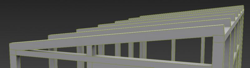

Added a roof! Please do comment on this as I've done some research and hopefully got the roof joists correct (below). Will be 1/2" ply.
Roof angle is around 7.5 degrees, which gives a 2/12 slope which I hear is a minimum but acceptable, as long as it drains? Also I know I need an extra vertical on the right, forgot to put it in.
Again, feel free to comment!
