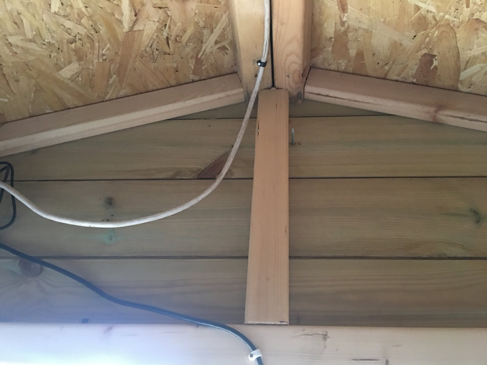

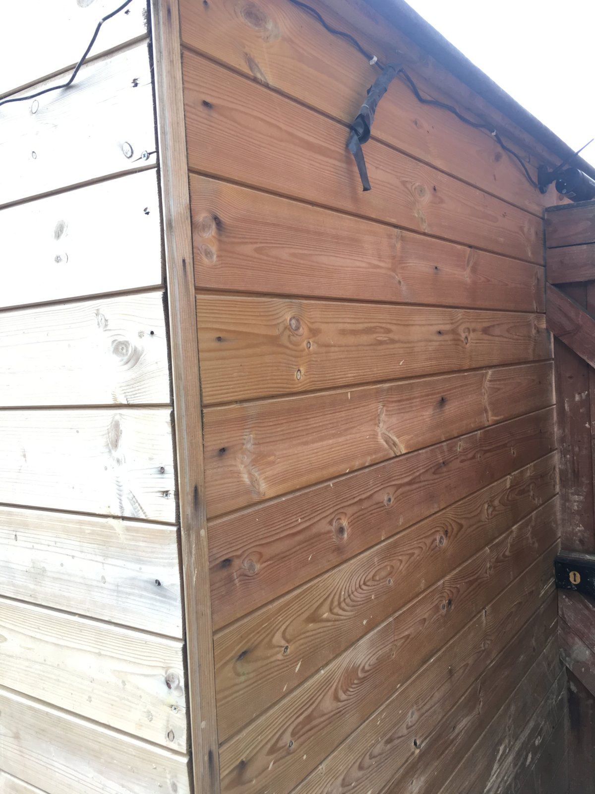

Since Im stuck at home with the kids until schools reopen Im getting a few jobs done..
I have a shed that I use for my gym stuff and every year I go through the same freezing winter months then into the scorching summer months.. so Im looking to insulate it on a budget and without taking up much space..
my old man has rolls of loft insulation (the itchy stuff as he described it) and a load of chipboard..
my plan was to stick insulation in the gaps then staple on some polythene sheets and hammer the boards on...
But Im reading now that I need gaps.. and vapour barriers etc etc!
So then I looked into kingspan.. which costs far too much although I know some will say ‘pay the money and do it proper’ but its not possible.
So any info/ideas on what to do would be greatly appreciated.. Im crap at all things diy I must add!
Don't over think it. You can do as you propose no problem. You don't need the polythene (other than to retain the insulation) or a vapour barrier.
The most important thing would be to make sure the exterior is wind and watertight, as you don't want damp insulation or draughts blowing through.
