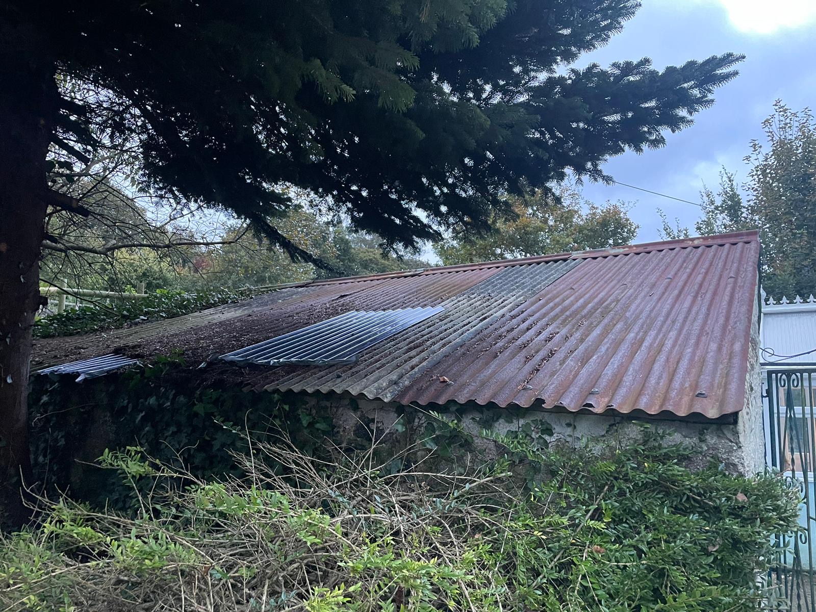

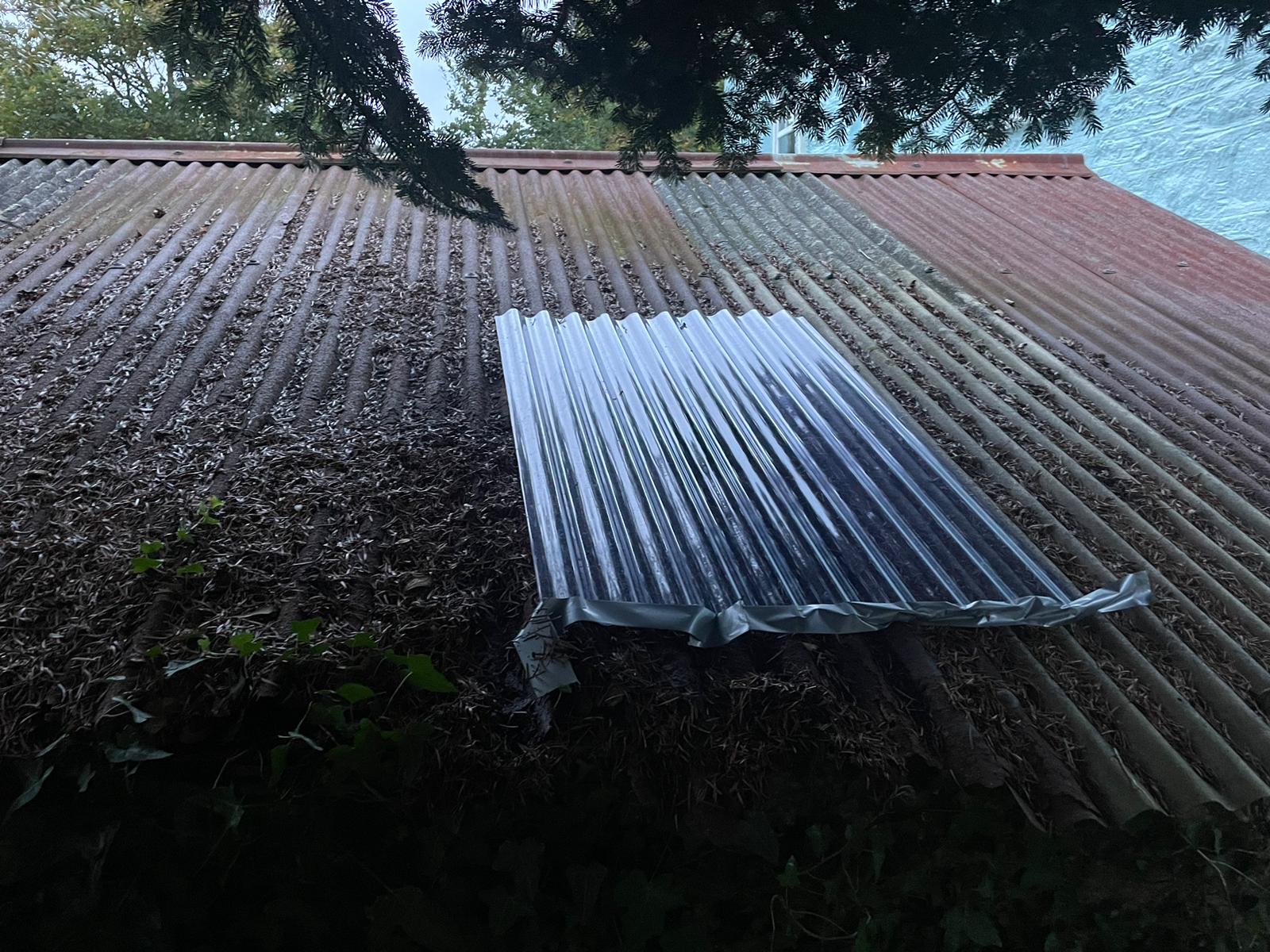

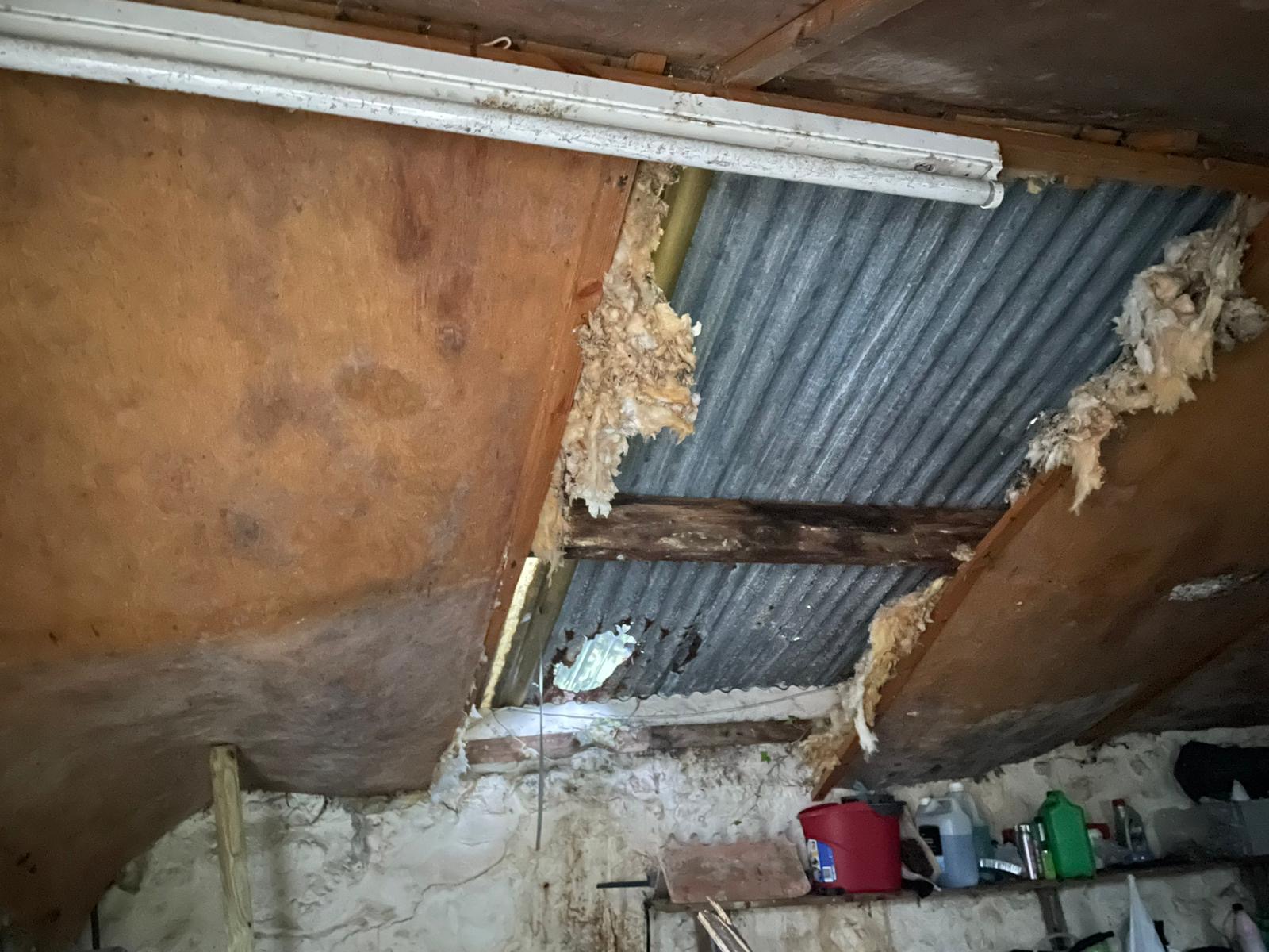

Hi, need some help please! Went in the shed this evening and the roof covering had collapsed, with a hole ️ in the rusted old corrugated sheeting.
I’ve put a bit of plastic roofing over it for now , but as soon as it gets a gust up it’s going lift off , or rains it’s going come in! And I live in Cornwall so it’s going do both soon
I’m after ideas on how to fix a tarp over it till get a roofer round.
There nothing to really fix to, and the roof so rotten you can like you finger through it .
Anyone got suggestions please?
And also a rough estimate to replace with new corrugated rood?
Cheers

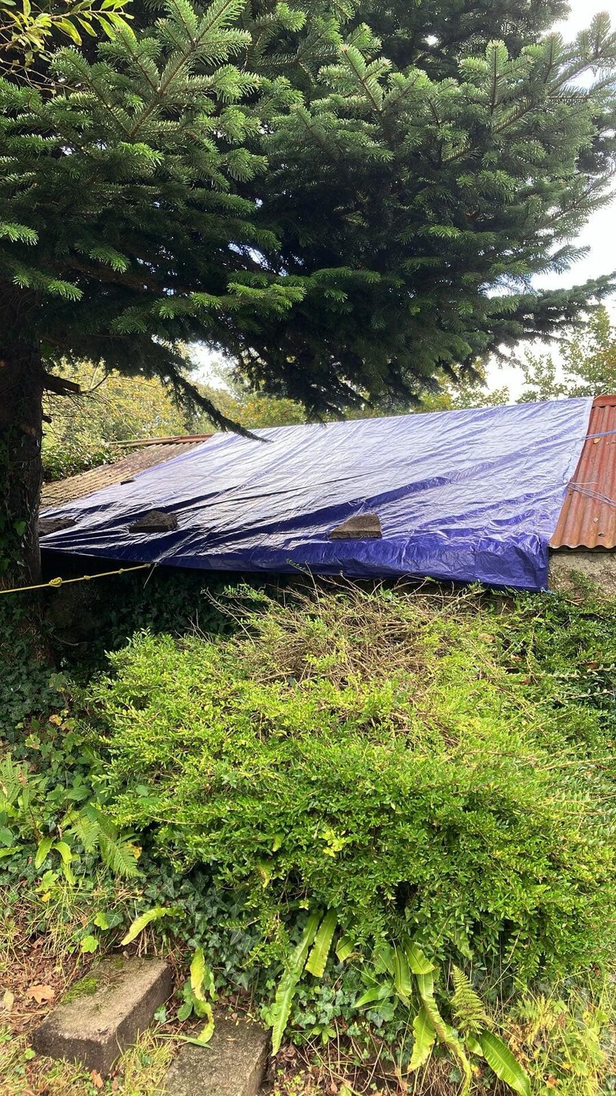

Large tarp, tie rope (the polywotsit stuff will do) to each corner and the middle sections, fling it over and peg it down like a big tent or drill some fixings into the walls and tie to them.
Think like a boy scout, not a brownie selling cookies :)
If you buy some new corrugated iron (or there is plastic with the same profile) It will fit snugly over your old and stay in place without a lot of fixing. Of course you have to drill though the peaks to fix it to the timber frame beneath
