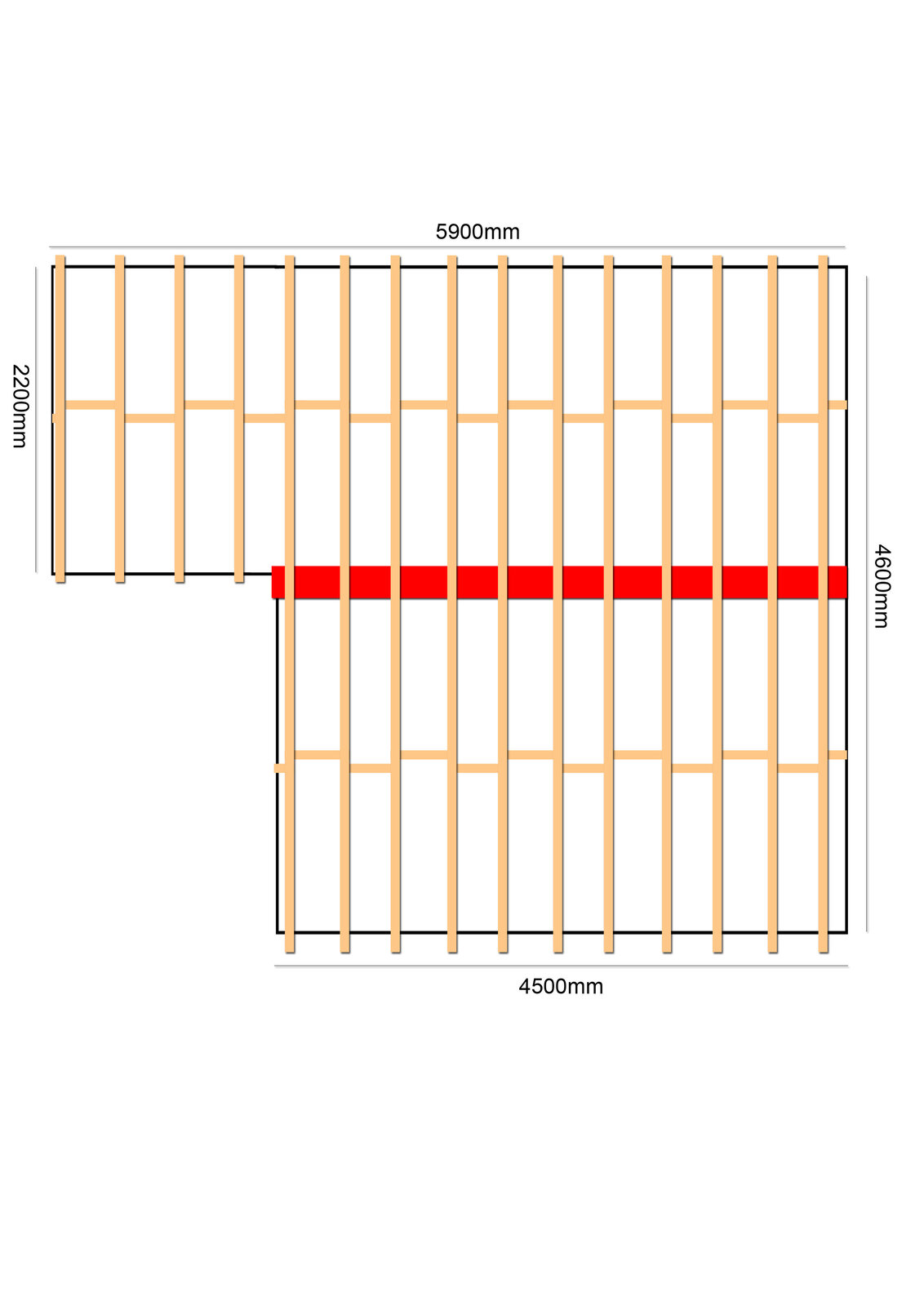

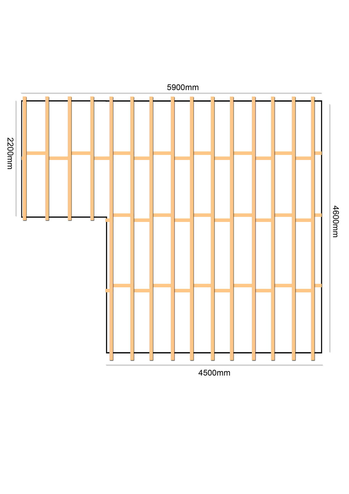

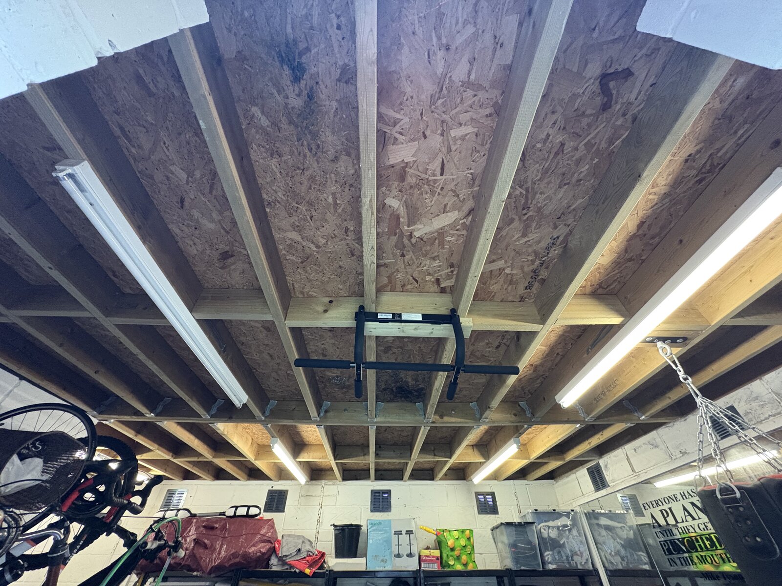

Hello,
Im going to redo my shed roof as it is currently sagging in the middle and pooling therefor leaking under heavy rainfall.
I’ll put a couple of images up of the current roof construction which is 6 x 2 with joist hangers off of a centre beam (2 x 6 x 2s bolted together). The span is 4.6m. I’m assuming 6 x 2 isn’t man enough for this span which is why it’s sagging through the centre beam?!
What should I replace the timbers with? Thinking 8 x 2’s but getting mixed info as to whether or not that will strong enough.
I have also considered dropping a support beam under the middle (perpendicular to the rafters) for them to sit on to prevent any future sag. Is this a good idea / needed?
Main roof measures 4.6m x 4.5m and will have 18mm OSB and EPDM finish with celotex in between rafters.
I’ve attached a couple of images of what I’m thinking of doing.
Be great to hear some advice
Thanks.

Where the proposed new red beam is, it looks as if you already have a continuous timber beam/joist across there, and that beam is dropping? A steel might be needed, under that beam, with timber spacers between the steel and the existing timber, to gradually wedge it back up to level. Another way, might be to try raising it with a temporary acro jack, then build a pier as a more permanent support for that timber, in the middle.

Keep the 6" x 2"s in place, prop the roof timbers and graft a timber filleted steel beam up between them (red line, last image).

Sight along, under the beam - how much does it dip down?
An acro jack, would be a quick way to see what could be done by adding a pier, with minimum effort.

If you don't want a prop somewhere near mid span and you don't want to lose headroom by undermounting a steel then the next option would be to either totally replace the whole thing (which seems a waste as the joists look ok as far as we can tell and even the osb is showing no obvious problems) or inset a steel to directly replace the inadequate double. It's a shed so you don't have to slavishly follow TRADA tables in fact I suspect if your 6x2s were continuous you wouldn't be making this post.
Peesonally I'd just sort out a steel to go under what's there and accept a small local headroom loss. With a bit of low engineering cunning a 100 wide RHS laid flat should be adequate. Not terribly structurally efficient use of steel but far and away the easiest option. They are available either at either 150 or 200mm and a variety of wall thickness. This approach has got me out of a few tricky problems over the years. If you crunch a few numbers even a smaller section might work.

If I was to replace the whole thing what would you recommend?
If I was starting again should I have added a steel / wooden beam / purlin through the centre under the roof structure for it all to sit on and if so what size would this be?
Should I have used 8 or 9 x 2s?

If you do start over then 8x2 at 400crs will match TRADA deflection limits, but in the real world 7x2 would be fine for a shed.
If you go with Noseall's suggestion take the existing centre timber completely out: you'll struggle to get things straight and you'll have a sketchy connection.
