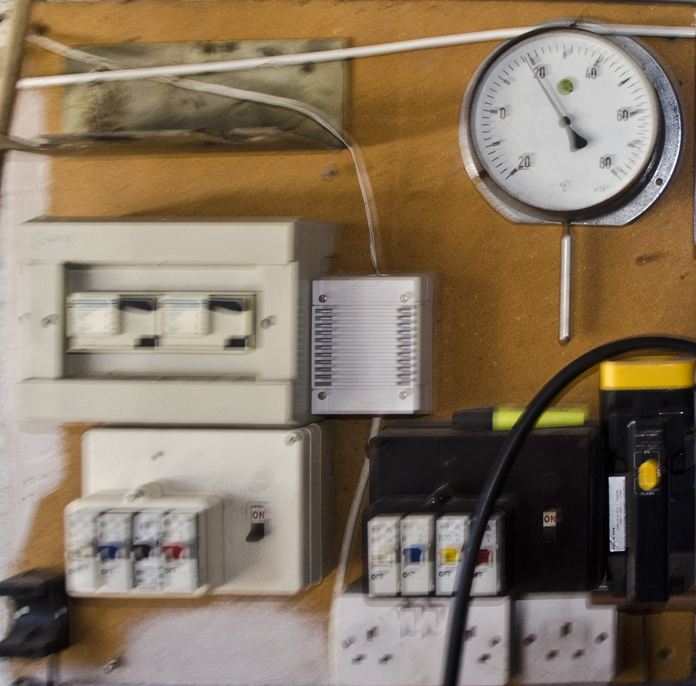

This is a bit outdated 2005 but gives the basics as to what is considered as a new circuit, one can argue until the cows come home, I added RCD's to an old Wylex fuse box Wilex-board-with-RCD.jpg many years ago, around 1992, at that time no Part P and to get a consumer unit which had twin RCD's was hard, times have moved on. However to put the old supply into a RCD FCU and then to shed may be possible.
