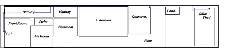

Hi There
Looking to build an office shed but want some advice on the best
way to run a supply to the shed.
The CU is at the front of the house in the front room and the shed
will be in the garden.
The distance between the CU and Shed will be about 40-50 Meters.
The CU is Split Load RCD.
I was looking into running an SWA supply cable from the CU to the shed
but i wanted to know what the max distance is allowed.
Also I have a spare 2.5mm T&E which i runned not that long ago
in the kitchen with the new harmonized colours.
Is there any chance i could use the 2.5mm T&E to supply the shed. ?
Will only be using the shed for 2 computers, 1 server + lighting and
maybe a standard 3-pin plug heater.
Thanks, Jagz

its a terraced house in north london
we have an extension as well with a concrete floor so i will have to
Burry the SWA cable into the wall.
Not to sure how far in to the brick wall.
As regards to the earthing system i think its a TN-S system.
hope that helps.
I'm just looking to install 4 wall sockets and some spot lights.
and as for route please see the image.
Blue is SWA cable.
Thanks, Jag

There's no reason why you can't use TE 4mm, 6mm or even 10mm in the internal run from CU to external breakout and change over to swa to cover element and mechanical protection.
You don't seem to have grasped that volt drop comes in to play and we need a fairly accurate distance assessment to offer advice on cable sizing.
You also need to confirm the load at the shed in watts / kw so the cable can be calculated for drop and installation method.
So come on stick your nose out and tell us what sized fuse / load you will need:-
10a = 2300w
20a = 4600 w
30a = 6900w
Be clear about the items in the shed, there's no point running something that trips daily, so assess the use of sockets and come back with the detail requested.
