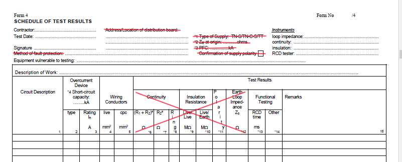

This label is basic saying the user must check when the caravan is on site, the PIR became the EICR, but the report would need modifying to allow for fact it is going to be moved. As long as some where in the report you have some thing like "I being the person responsible for the Design, Construction, Inspection & Testing of the electrical installation (as indicated by my signature below), particulars of which are described above, having exercised reasonable skill and care when carrying out the Design, Construction, Inspection & Testing, hereby CERTIFY that the said work for which I have been responsible is to the best of my knowledge and belief in accordance with BS 7671:2018, amended to .............(date) except for the departures, if any, detailed as follows." that is enough.
The normal form has many items which are not applicable.
So to use the form would seem pointless, I would design my own form with all the useless bits left out, and issue it as a certificate, but of your own design, so there is no information as to supply characteristics as this will clearly change site to site.

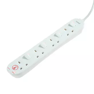

I see the idea of it being an electricial installation, however until installed on site, it has no electric nor is it installed.
I would think there would be a system for pre-assembled or part assembled systems, blagdon made pre-assembled garden equipment which as it was pre-assembled got around the then new Part P law for work in the garden.
I do not recall any inspection or testing paperwork which came with it.
Essentially it is no different to any other preassembled electrical device, such as
