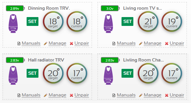

But every home is different, last house modulating boiler, so set the lock shield valves by looking at the TRV report. 4 TRVs-1.jpg Easy enough if a TRV reports the current is above the target, then clearly the lock shield needs closing, and visa versa, and I got the house so each room was spot on. Thought great, know how to do this now, moved to this house, and did not work, basic all lock shields wide open.
