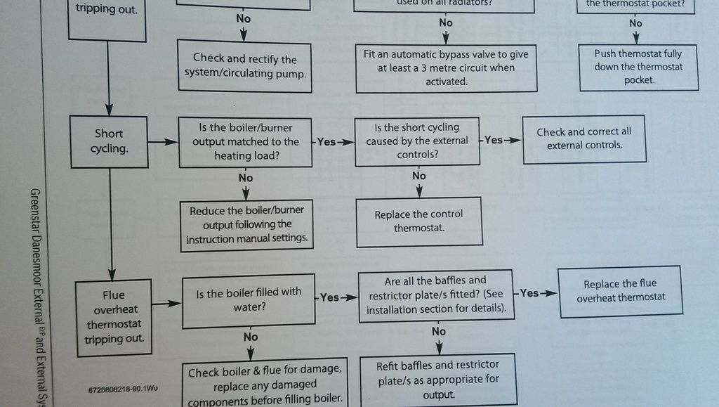

It doesn't mention anything about that in the literature. Does anyone know that for sure?
This is all it says in the manual about short cycling:

Forget the 2 minute cycle, it does not exist on your boiler, Tony needs to stop applying gas technology to oil boilers.
