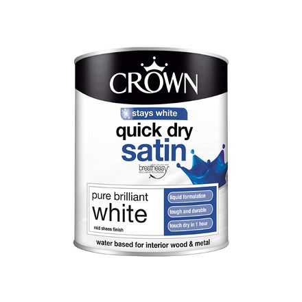

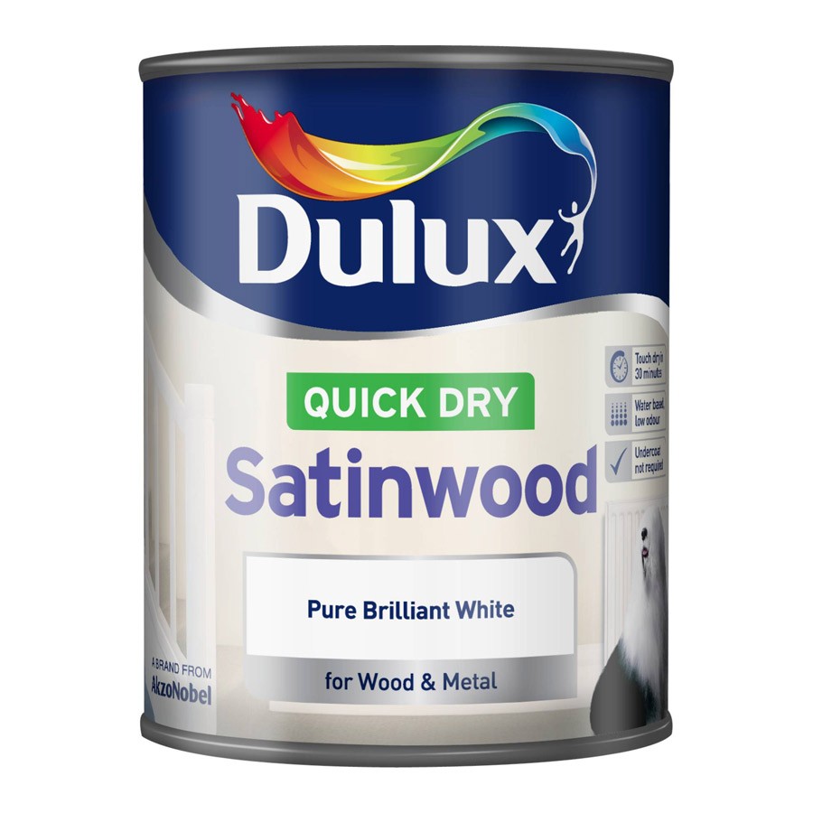

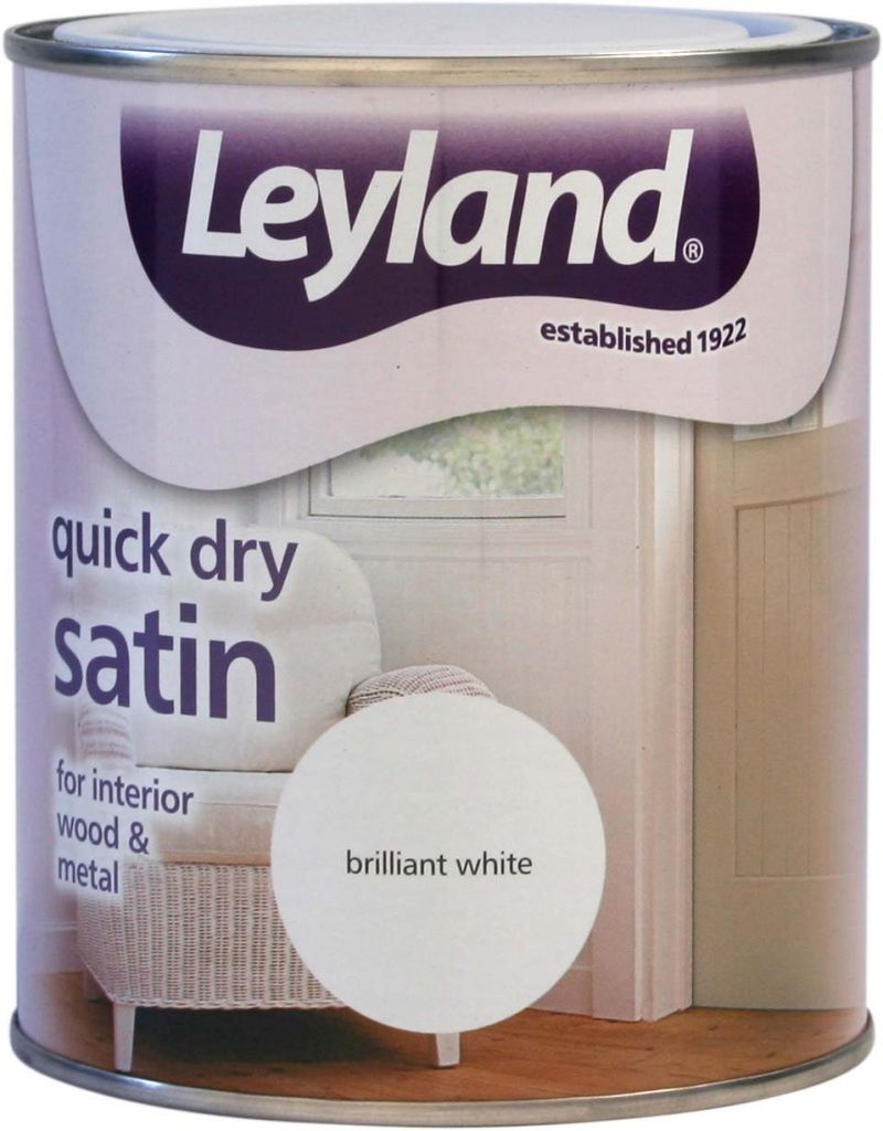

Just painting a pine bed that has been in a natural varnish state. Have undercoated it but
suddenly realise, should I have Knotted it first or will the thin layer of varnish act as a barrier?
Which one of these do you think will do the job well or are they all a bit of a muchness. All £10-£12 delivered off ebay.

Many tradesmen use shellac as a knotting solution. Unfortunately nothing is guaranteed to work. Shellac is probably better than nothing though.
If the bed has already been varnished, you need to give it a very, very thorough sanding, otherwise any paint that you apply will be prone to chipping (sorry).
With regards to the paints, neither is the trade version of Leyland or Crown, so I can't comment other than adding that I would not want to use either. As a professional, I don't buy cheap paints. Why save £10 if you need to spend another £180 on extra labour. That said if you are using either in your "free time" (and that free time is rated at very little) then go for either if you don't mind having to apply 2 or more coats than the trade version.
