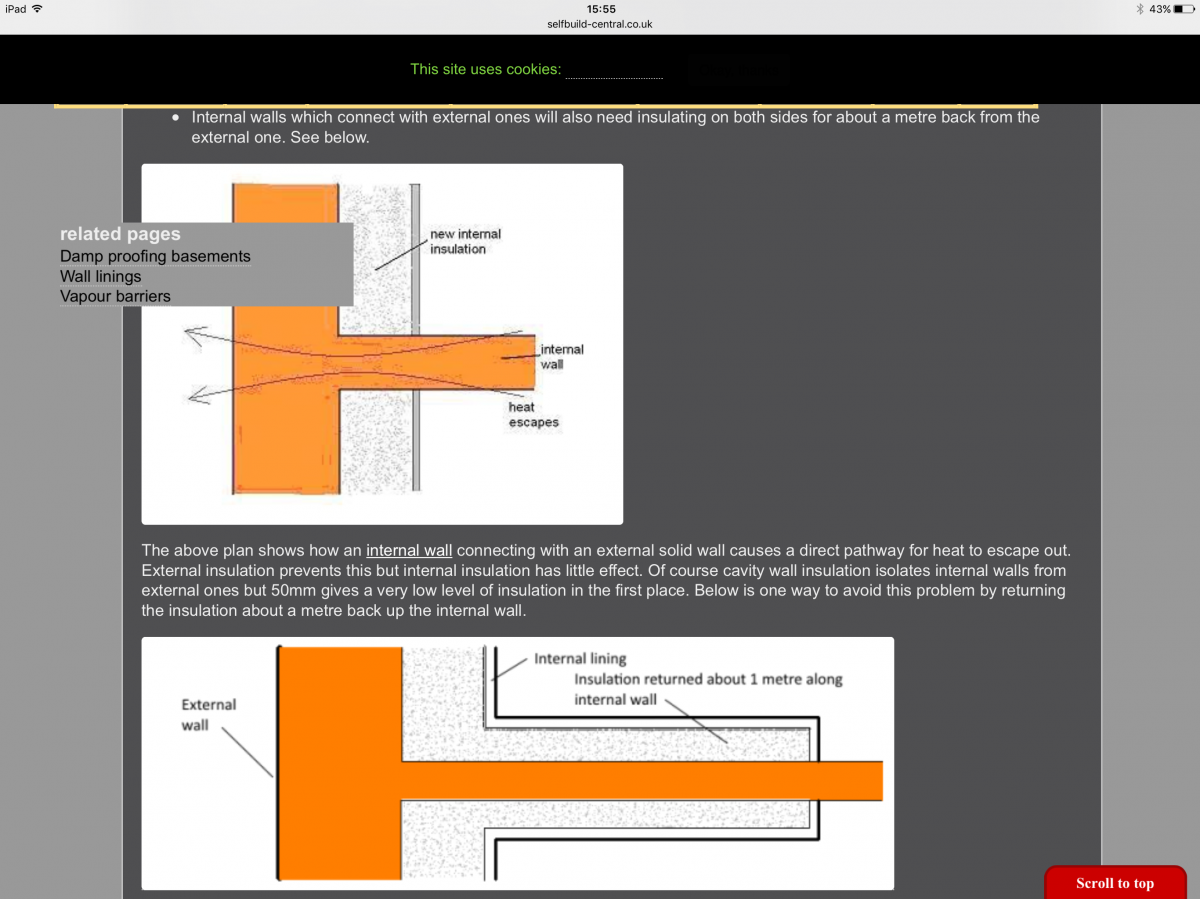

Should I insulate with insulation board between the framework on the old house wall? (blue wall in pic) This wall has cavity insulation.
It will be covered with 12.5 mm Plasterboard.
Thanks for your thoughts.
Stu
Not to answer the question but what are you stud spacing on your stud wall?
You can insulate in your void however you have to be careful that you wont create condensation risk as the external wall will be slightly cooler than the air due to the insulation.
The thinness you are talking about, 50mm of rockwool, I should think would not cause this problem.
600 to centres.
The pic is an older one I had, work has progressed since, completing the stud walls.
I cannot see the point of insulating this wall, This was the external wall and is now internal due to extension ( i think) you say it already as cavity insulation, but it is now an internal wall. unless you are planning to have differential temperatures inside the house i would just board skim and decorate.
Thank you. That what I shall do.
