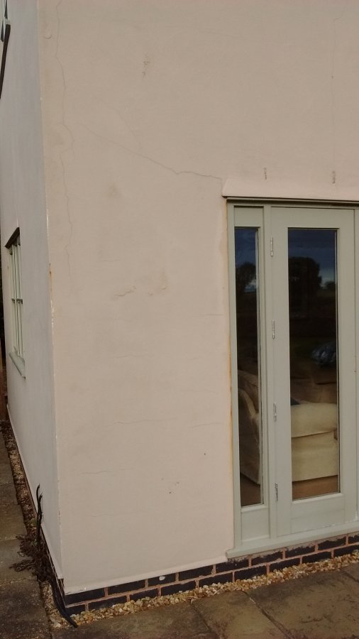

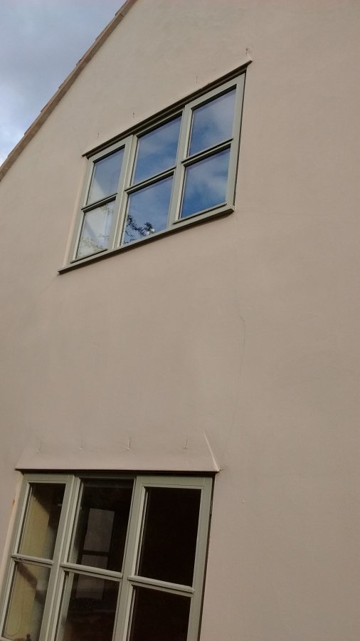

What does it mean to have a rusting corner bead? Water ingress causing the rust?Good call ref the rusting corner bead - obviously not a plastic or SS corner bead.
The rest of the house was already rendered when this extension was added, so it was to tie in.Wonder why it was rendered 10 yrs ago?
Don't know, why would you have a french drain? It is around the entire house.Why the French drain around the house?
I don't understand the distinction... I don't know if it was crack filled, but the entire house was re-painted.Was it re-painted 3 yrs ago or simply painted and crack filled just before the sale?
No interior damp signs.The frames are not set back the recommended 75mm - hopefully not an issue if no interior damp signs.
Not that I know of. There are cracks elsewhere, but no large ones.Any history of remedial work on the walls?
Yes, this was built in early 00s. It's fibrous - I know because I was in the eaves at the weekend and the cavity appears to be open.Does it have cavity insulation?
