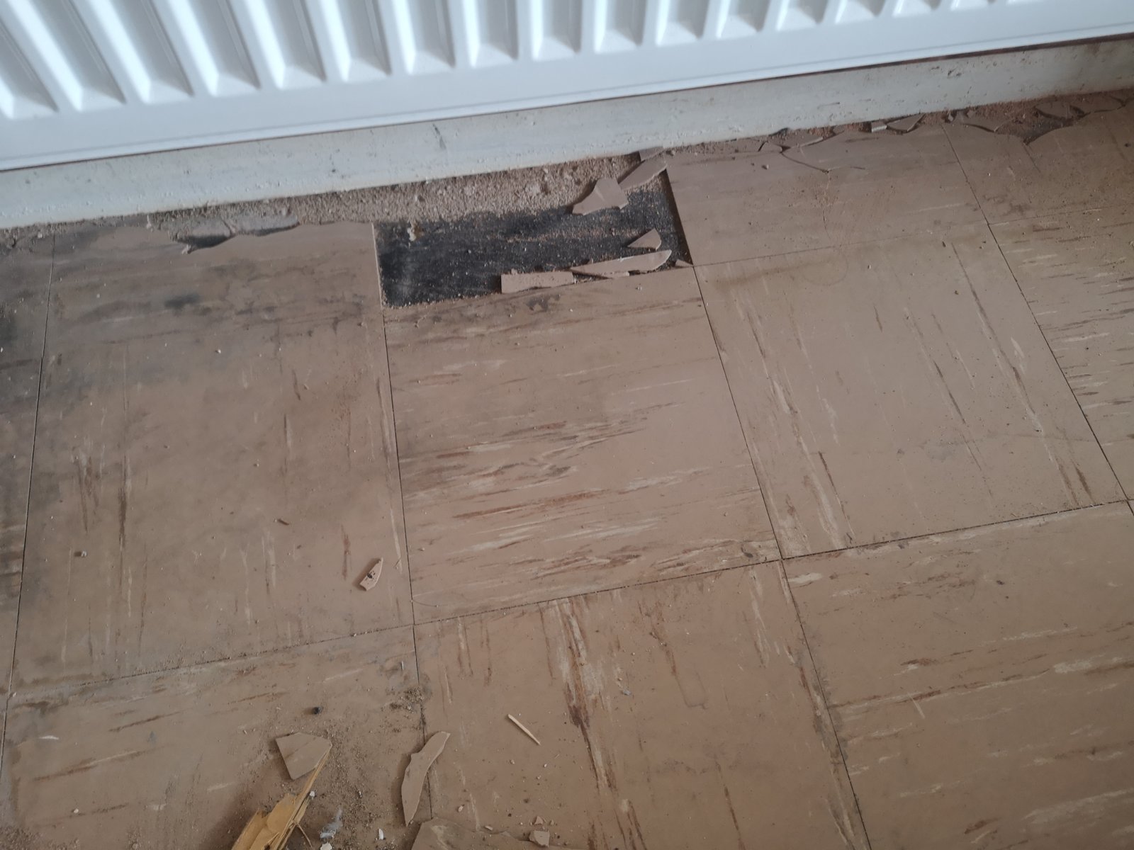

Hi
So I have a solid cincrete floor in the living and dining room and the kitchen, the living room has all these tiles attached and alot of then near the lifting are crack or broken, question is , should I be pulling all these up? Or once the underlay etc is down there really no need before we carpet (long way of that yet lol)

bricksmasher, good evening.
If these floor tiles are the old Thermo-Plastic they may contain Asbestos? have you had them tested?
Is the black material on the concrete a DPM? or just a black glue?

A lot of vinyl (Marlley) floor tiles and the adhesives used to lay them could contain asbestos right-up to the 1990s. Fortunately it is chrysotile, the least harmful form of asbestos, but the scrap/waste does need to be treated as a toxic waste, double bagged and properly disposed off (so not just in the bin)

As JobAndKnock above, OK the tiles may??? contain Asbestos, the type of Asbestos in these tiles is no where as near dangerous as the other 2 types [Brown + Really dangerous "Blue"] Same applies for the Adhesives used at the time.
I hate to think how many hundreds of Square meters of these tiles I have seen being fitted, in Government offices ??
Suggest you contact your local Authority about disposal, as above probably double bagged in cleat polythene?? I for one have absolutely no idea what the disposal regulations as regards your Local Authority
As for DPM, a building based terminology for " Damp Proof membrane" meaning the layer that prevents moisture from entering the property, But as the "black" material on the concrete comes up easily, then it must be a relatively "thin film" that is not a DPM
Loads of information on this site as regards these tiles and i assume a lot of info on the Web.
How about you think about overlaying the tiles with a self leveling compound? that will negate the need to lift all of the tiles?

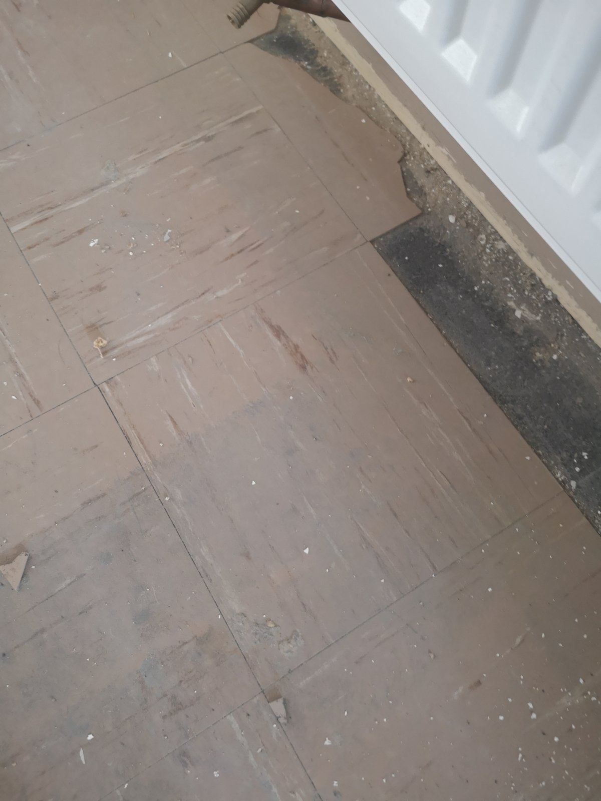

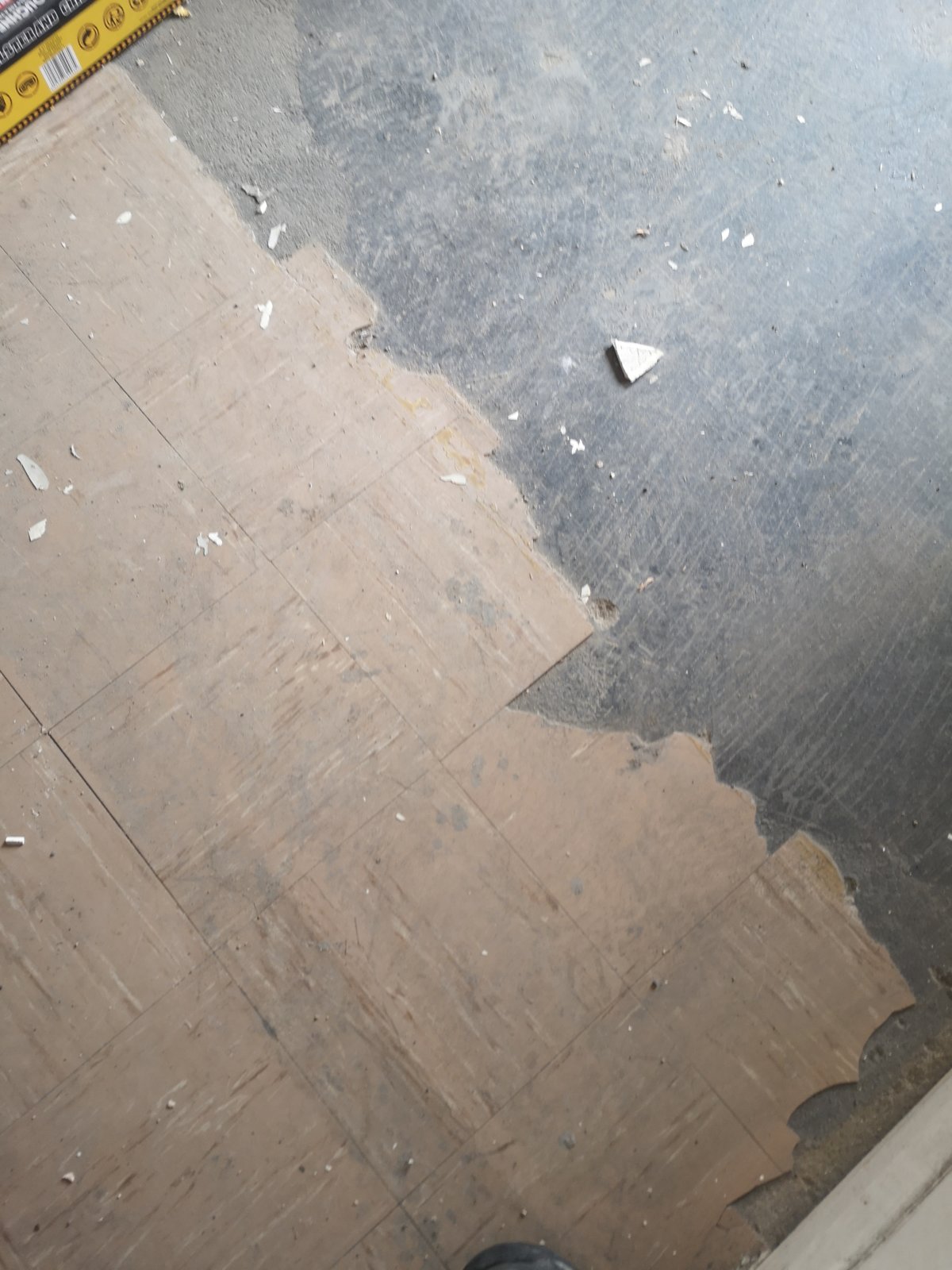

My brother in law is s builder and I just showed him and he said may as well continue pulling them up now but I'm not too sure lol
The black onon t floor is solid, I haven't tried pulling that black off, basically there was work tiles in the kitchen flue to the black floor
Then there was cork tiles glue on to the dining room, which was then glued onto the greyish tiles showed above so.insyarted pulling it all up thinking I was doing s good job
The living room is just the same grey tiles with the black concrete underneath
So if these great tiles come off easily without breaking maybe I should keep pulling them up and then getting advice on the removal of them in case of should.i send off for testing do you think? Thought the amount of dust in the air and amount of times. IIswept over them I'm not sure there's much I can ndo now

Damp down everything, double bag the rubbish, wear an FFP3 dust mask (e.g. JSP Force:cool: and DON'T use a domestic vacuum on anything as it will redistribute the fibres everywhere)

It is an offence to dispose of asbestos to anything other than a licensed waste site, so yes, lobbing them in the bin could result in a fine were you to be caught.
Thanks so general advice is to go to the council then?
Sort-of. Your local council should be able to take correctly labelled double-bagged crysotile waste for disposal in a safe (i.e. controlled) site. My council does. They also sell the red bags they require and they charge about 75p/kilo but the minimum quantity is 50 kilos. See here for an indication of the sort of rates the trade pays
How would I go about getting them tested or the local authorities can help with that?
Not the responsibility of the council. For testing look-up "Asbestos Testing Services" but avoid labs based outside of the UK
