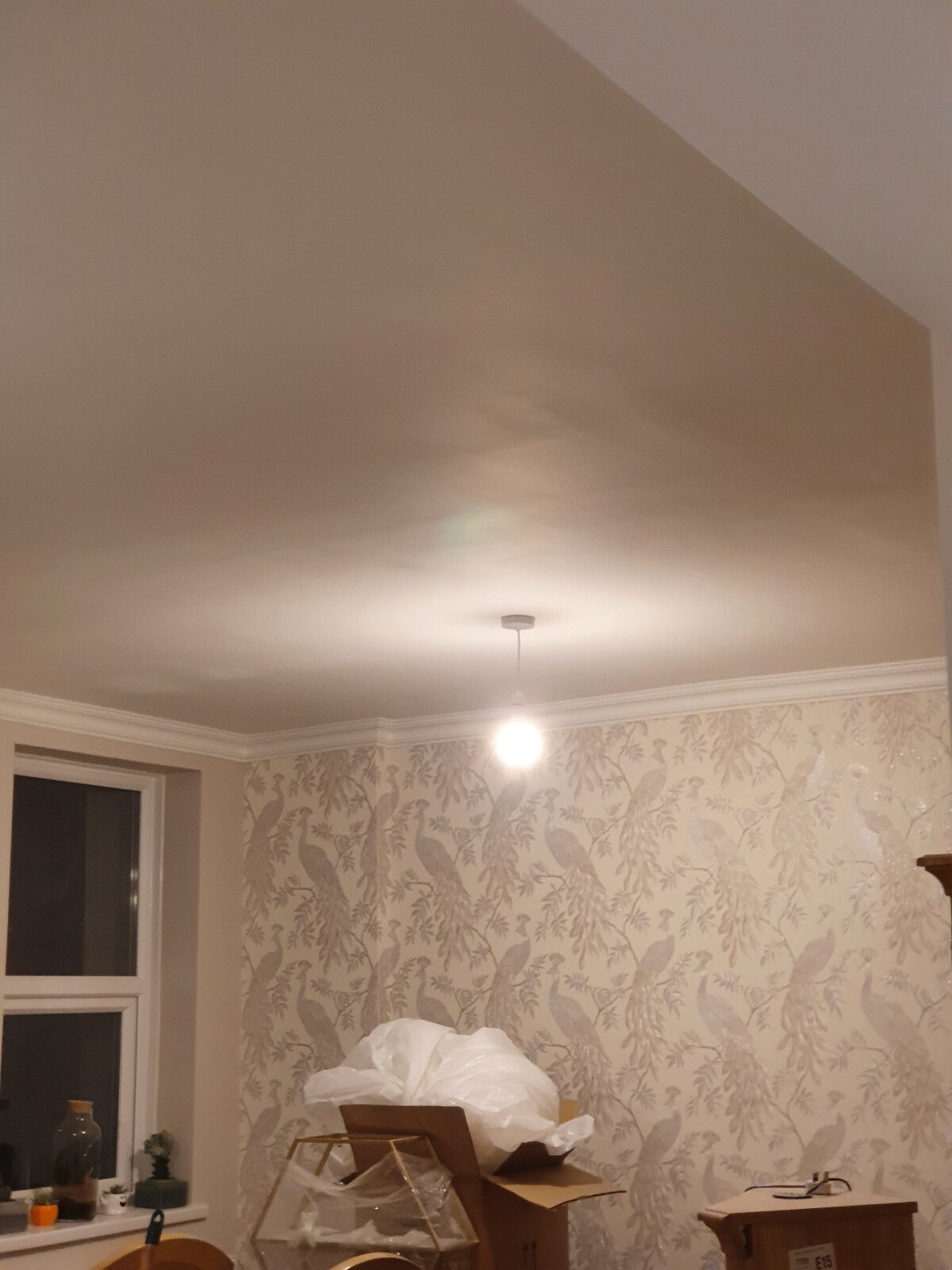

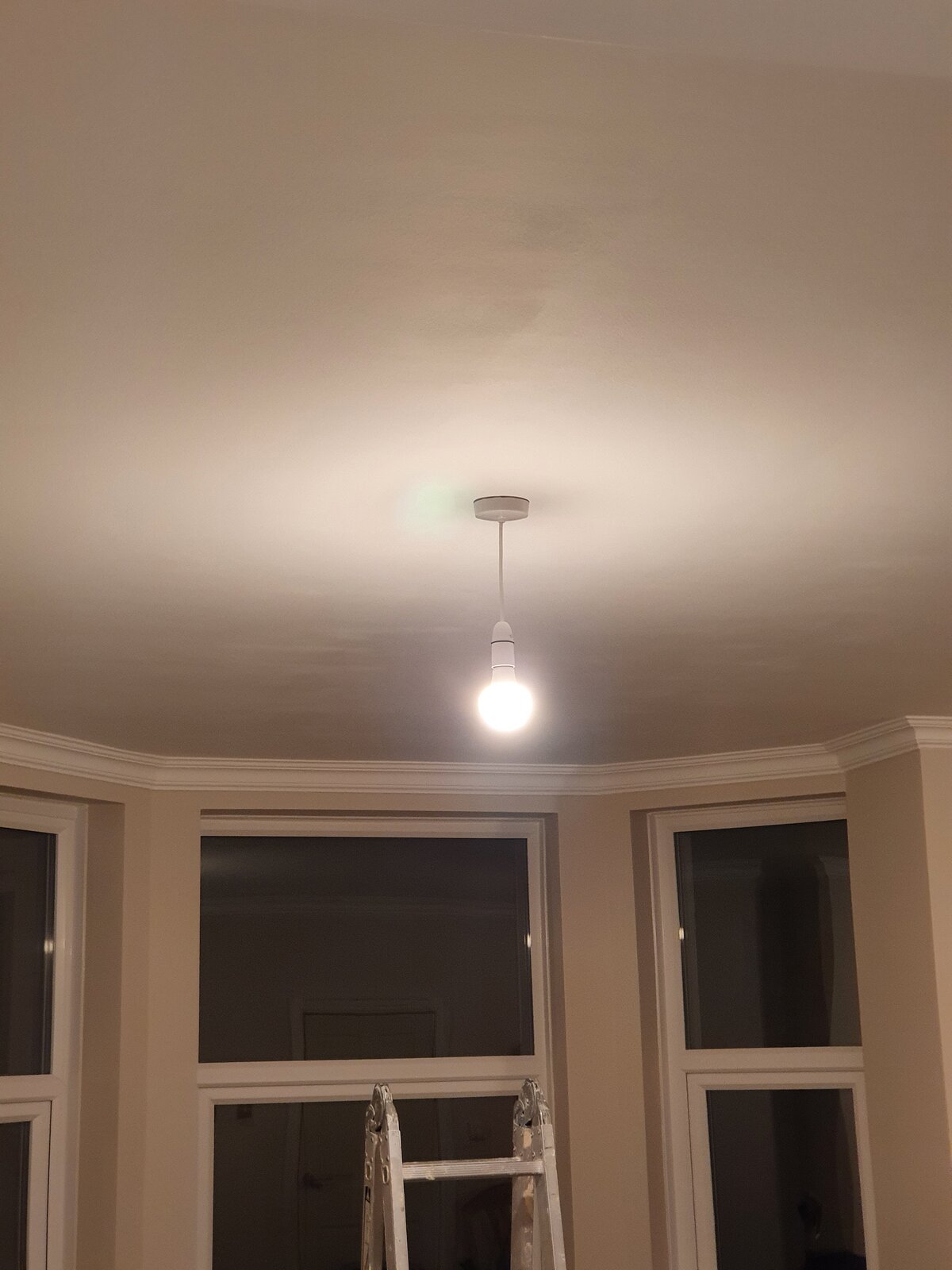

I took these pictures last night. You can see patches flashing everywhere because it dried so quickly that I couldn't even lay the paint on. But I don't understand why it's so absorbant.. it was grey plaster, it is an old building.
