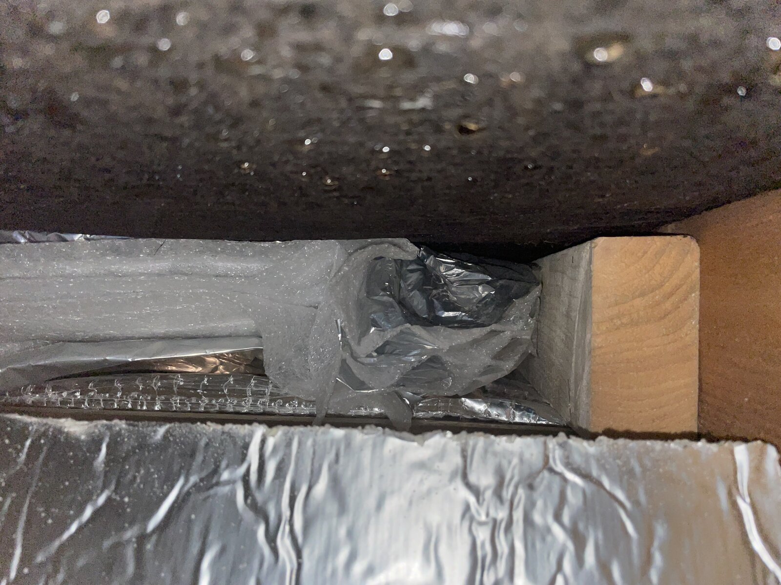

I can see the insulation is like white wool but inside these fiat silver bags, and looks like 2 layers of them but don't know if there's more further in. They don't look 50mm each.

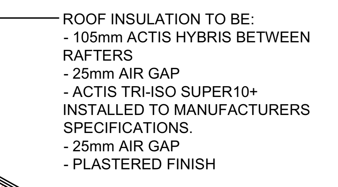

Is it a multi foil
they need an air gap either side to work
It's supposed to be this as per drawings but I don't know. I can't see or feel anything that's 105mm thick. It's just a few of those silver sheeting things above plasterboard.
The first image looks like act is hubris.
have a look on their website and see the installation instructions.
I always wonder how much the thermal performance of multifoil systems is compromised with incorrect / poor installation.

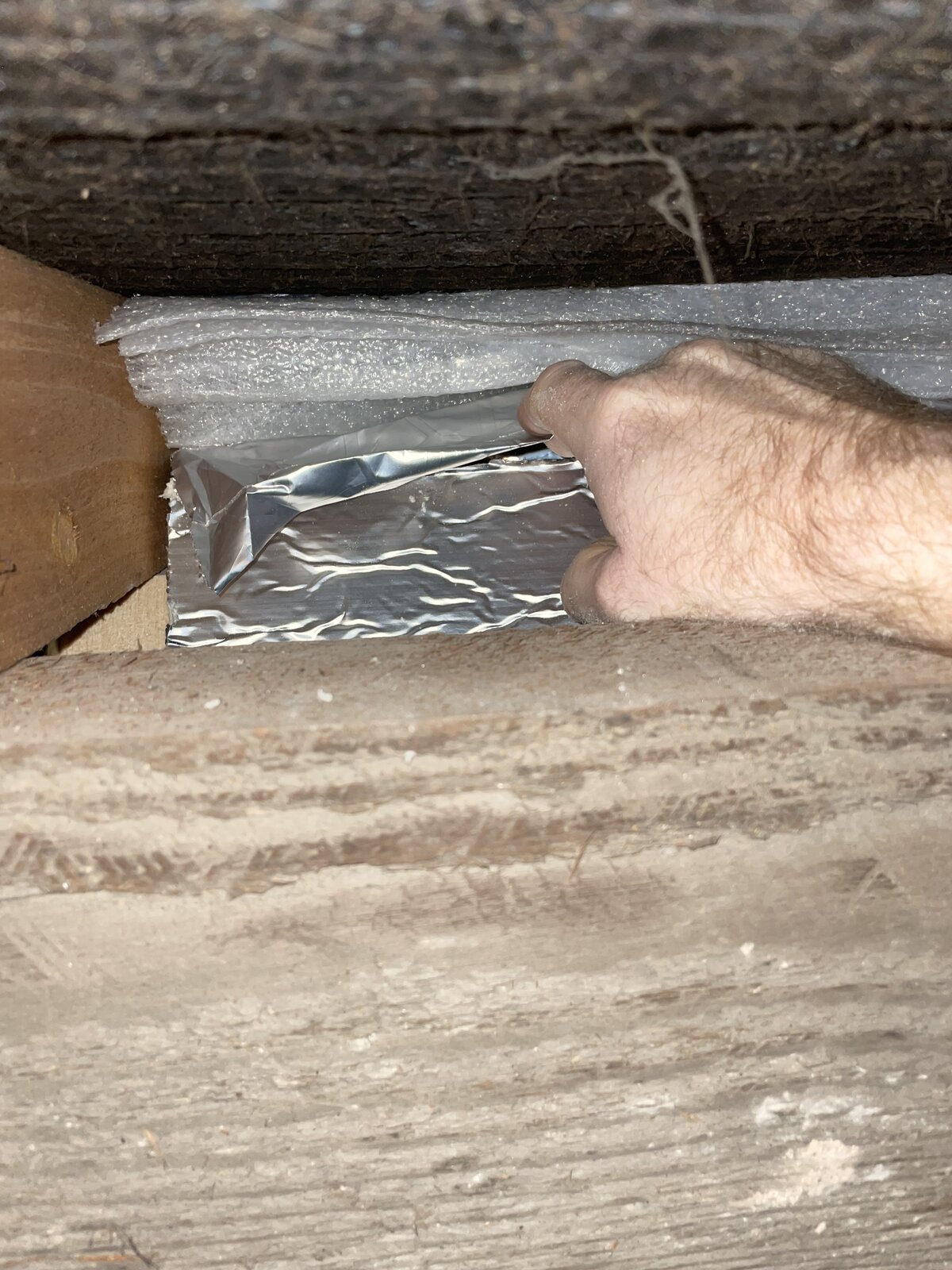

But the actis hybris 105mm looks like some sort of honeycomb system that's 105mm thick. I can't see that. But those sheets could be the actis tri-iso super 10.
The first image may be deceiving. The foil between my thumb and finger is the top of vertical kingspan on walls, not ceiling insulation.
Image 1 looks like the side view of actis hybris the whitish foam at the top of the picture is the honeycomb
image 2: cowboy install, it’s showing the A) LHS of rafter space filled with actis hubris roll that’s not long enough and an offcut shoved in to fill the gap - if you look to the right of the picture you can see the honeycomb, but it’s squashed up.
Ive fitted hybris actis so I know what it looks like
I'm going to upload a video to drop box as I really don't think there's a 105mm insulation there and looks like a few of those sheets only.
So it can squash down? So not 105mm?
