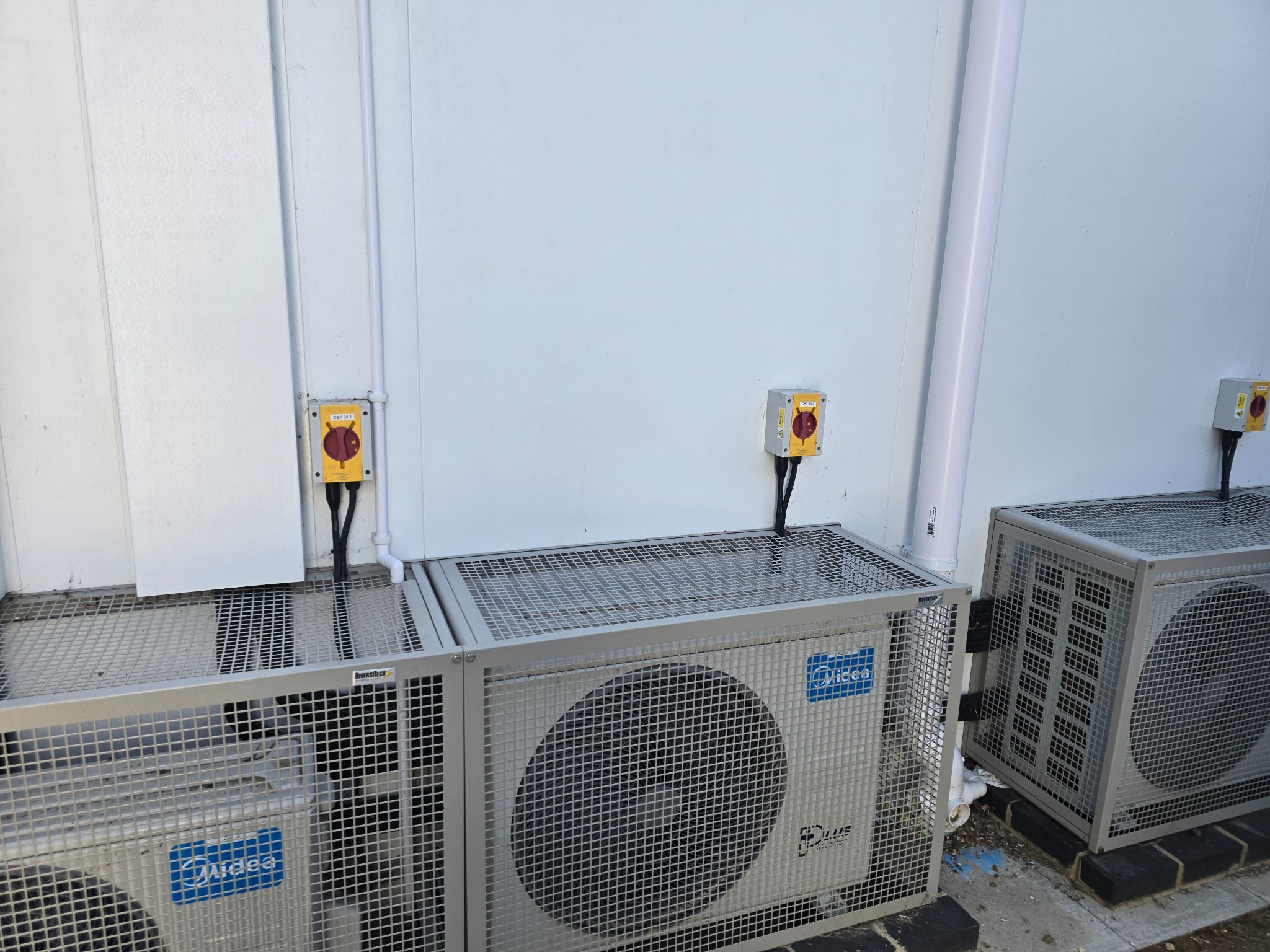

They arepresumably safe enough for anyone (including children) to touch, as they are, but if it is felt necessary/appropriate to do something to make it more difficult for primary school children to 'fiddle with them', that might perhaps a different matter!Should these isolation switches have guard at a primary school?
Not to my knowledge. As we've agreed, they are designed to be safe 'as is'Thank you John for responding. Im assuming they are nit dangerous, I wondering if regs state anything.
As I implied, that's obviously a potential issue that you might want to address - but it's not really anything to do with electrical regulations. After all, 'the pests' could interfere with any switches they come across (light switches, switches on sockets etc. etc.)These are for the Air con units. The pests keep turning them off.

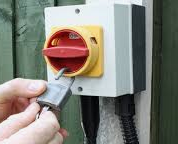

Locked on? Didn't think you could lock on.View attachment 415387 Normally they can be locked either on or off.
Good man. Thats a treatView attachment 415387 Normally they can be locked either on or off.
ShiťLocked on? Didn't think you could lock on.
I think I know what your thinking.I have a drill, I think I know what I would do!
On the isolators that stick out, I can see you could just drill an extra hole to allow them to be locked on as well as off, but is that possible to do that on these ones with the recessed actuator?I have a drill, I think I know what I would do!
No, that entire area should be restricted access.Should these isolation switches have guard at a primary school?
