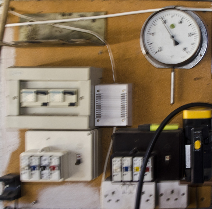

However through history it is not the installation designer who decided what protection was installed, but the manufacturer, when I fitted two RCD's feeding the two Wylex fuse boxes in my old house, Wilex-board-with-RCD.jpg I could not have fitted a twin RCD consumer unit as simply not made.
