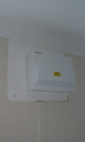

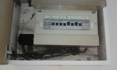

I have a small apartment. I decided to bring the consumer unit up to the latest regs.
Just wanted an opinion on what the electrician chose to do.
It is an E7 property and had two consumer units. The main consumer unit fed the secondary unit which was for the e7 heaters.
The main consumer unit had a breaker for the second consumer unit it seems.
After the work, this is the arrangement.
As you can see they replace the main consumer unit. But retained the secondary.
The new main one is all RCBOs.
I guess I did not expect the second unit to be retained. The quote made no mention of it.
It also seems the breaker to isolate the second box has been removed. I assume it was potentially redundant with there being a breaker on the second box anyway.
Thoughts?
seems a bit... naff to me?
Often in E7, the second board would have its own feed from the meter, which switches on when the system is "off peak". If thats the case, it shouldnt have been fed from the main CU at all?
If theres some alternative switching arrangement (eg timers on the heaters themselves), then it could all be in one board. You would really need to see what that 40A breaker was doing, and how the off-peak switching is controlled.
It looks like half a job done with the cheapest materials available.
Whether that's a problem or not depends on what was actually quoted for.
It would have been more usual to replace the whole lot.
The quote was simply to replace with metalclad fuseboards (plural) and bring up to latest standards including RCD and MCB protection.
This company was highly recommended and well known, had all the accreditation, and conducted an ECIR before hand to identify any issues.
