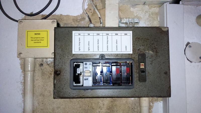

I am planning on having my consumer unit upgraded & it has been pointed out to me that the old installation does not have an isolating switch to disconnect the unit from the main supply.
Should I contact the electricity supplier (First: Utility) to install one or are electricians able to isolate the unit without the switch?
You need to contact your supplier or distribution network operator, normally a fuse pull would be requested to isolate the board for a swap. Either way you need to contact either supplier or DNO.
Before I put my CU in I had the DNO come round and fit an isolation switch. Cost about £70 so worth it for me. AIUI PBoD is correct that the DNO will need to pull the fuse but in reality most sparks will happily do it themselves especially as 'the seal was already removed when they got here, honest'
It depends on the cutout type. No one, probably not even DNO staff should be pulling the fuses on iron clad / ceramic cutouts these days, and especially not an electrician with no PPE :eek:
