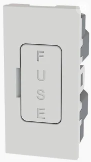

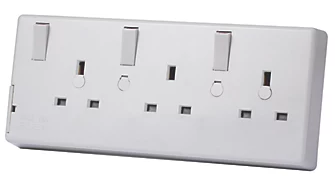

Ideally I also need sockets moving so accessible, and more sockets fitting, you can get these 1712406133695.pngbut they also have a fuse in them, so just look neater, fitting a larger back box 1712406275565.png if on a ring can increase the number of sockets, but if a spur it may not help, using one grid socket you can include a fuse 1712406453116.pngto fuse down whole lot to 13 amp, but in essence no different to having extension 4 way sockets. Just looks neater.
But the first step is to find if existing sockets are radials, spur, fused spur, or ring final.
