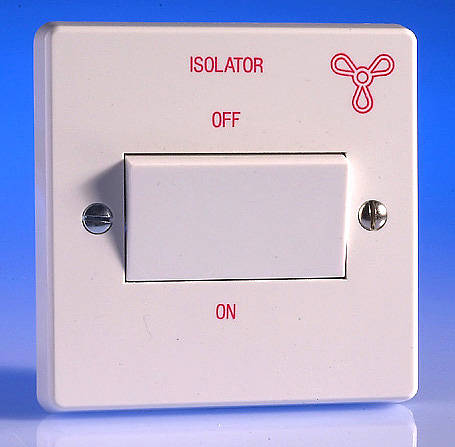

The new switch does not have to be double pole, BUT you should have some means of isolating the fan completely. You can either use a 3-pole (Live, Switched Live, Neutral) isolation switch between the fan on/off switch and the fan, or you can put a DP switched FCU in the circuit before the fan on/off switch - this would also be a handy way to comply with any manufacturers instructions about using a fuse, which quite a few fans have.

Given that my junction boxes are now fairly inaccessible and I can only get to the triple and earth wire to the fan I have bought a three way fan isolator switch that I'm about to place in the next room.

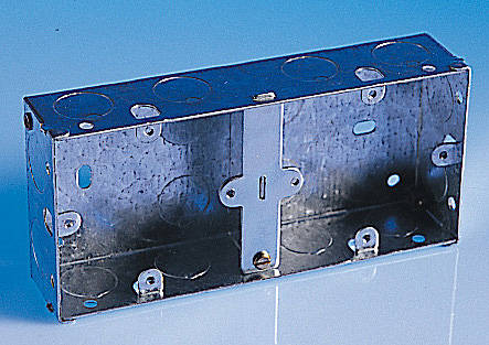

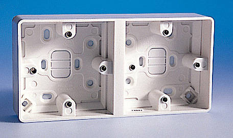

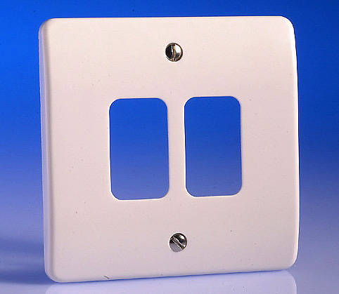

The neatest solution would be to use a dual (not 2-gang) box like one of these:
then you could neatly mount a 2-module grid plate with 2 fuse modules and the isolation switch next to each other.
