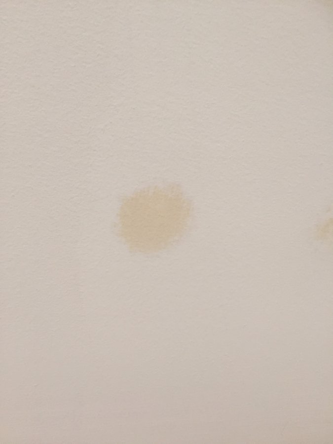

This morning I found a patch on my lounge ceiling. It is a bit different from the water mark i know of. The floor above is close to a shower cubicle. I had a shower last night. Do you think the mark is the result of shower leak? Any advice would be appreciated. A photo is attached. Thanks
When I touch the patch, it is dry.
If it is indeed he shower leak, what places shall I look? the sealant around the shower base or the drain? thanks.
Look at both and for staining on the floor, run the shower around all the edges and wall joins and check the trap and associated pipework joins for water.
