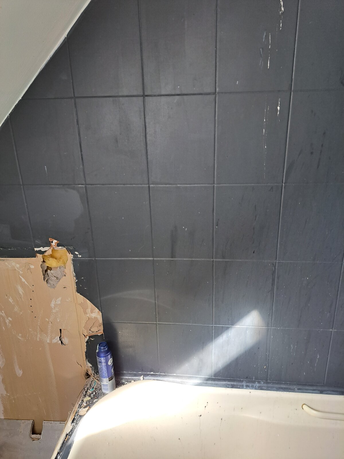

Rob, dont want to remove these old tiles as will damage wall, can I put panels on top?
also someone said to use stixseal
or pink grip, assume CT1 as good?
Yes - you can board on top of the tiles, as long as they are nice and secure and nothings loose.
