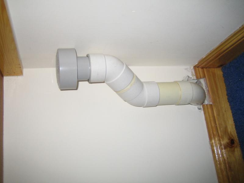

My shower in the en suite has what looks like an air admittance valve connected into one of the wardrobes behind the shower cubicle.
I haven't opened up the space below the shower base yet and don't know if it's in line with the shower waste, or connected via a t-piece etc..
Is this likely to be an air admittance valve?
If so, what is it's job and what should I be careful of when fitting a new shower base, trap etc...
An air admittance valve is connected to the top of a stub/stack pipe. Its job is to let air in and is usually used if the stack can't be vented or if its a stub stack. I don't understand why it would be connected to a wardrobe? :LOL: Can you take a picture of it?

The 40mm pipework comes through the wall from under the shower base, at skirting board height and has a vertical run (upwards) of about a foot or so, with this AAV then in the top.

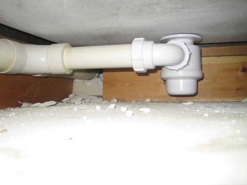

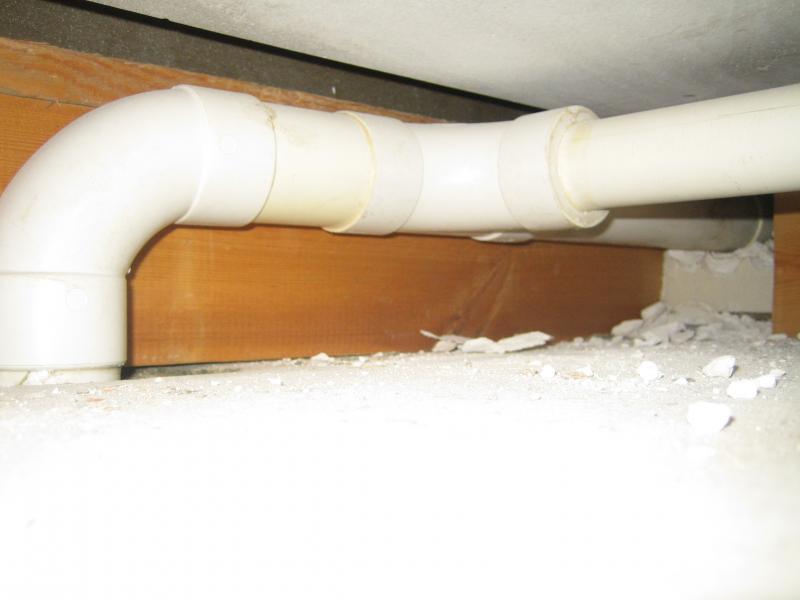

I've attached some photos of both the shower waste under the shower tray itself, where you can just about see the branch from a t-piece going through the stud partition - the first photo shows what is inside the wardrobe, though the picture is 90 degrees in the wrong direction.

As far as the shower waste goes, the last photo shows the 40mm waste pipe going into the floor, where it presumably runs to the same stack, which is about 8 ft away, but the run must be within the height of the floor joists.
It’s as I suspected, a small AAAV intended to vent the shower waste run; I am, however, a little surprised you need it :confused: . You have separate runs into the stack for each appliance, as it should be, & the lengths of the runs are well within design criteria for unvented braches! Is the vertical stack internal or external? Is it actually vented, either by an external open vent or another AAAV? Does the stack appear in good condition?
Presumably, one was/is necessary or someone wouldn’t have gone to all the trouble of fitting it in your wardrobe! Can you tell if it was fitted when the tray was installed or has someone bolted it on afterwards? Before you decommission the exiting tray, I would be inclined to remove the valve & temporarily block off the pipe off just to see what happens; based on the info you’ve given so far, I can see no immediate reason for it being there :!:

It won’t cause any problems with your new tray or basin; one thing you must watch is that the top of the AAV must always be above the highest point that water could ever back up in the event of a blockage, usually the rim of the wash basin is the highest flood line.
As I said, with separate connections & the length of pipe runs you have, I’m at a bit of a loss to understand why it’s there!
I'll check the top of the stack when I get home - this smaller valve in the wardrobe is definitely LOWER than the height of the basin though. The top of the valve inside the wardrobe is about 18 inches from floor level
