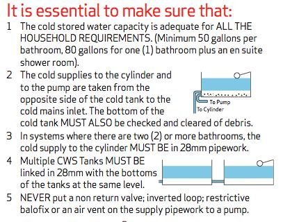

ok the pump supplies the shower only and not any of the other hot water The pump is a standard one of these types and nothing special Salamander is the make. When activating the shower, the pump (in the airing cupboard) does the normal continuous whooshing sound. However when the shower is off but you run the hot water tap in the bath the pump "hunts" it kind of has a pulse - on off on off kind of thing.........actually its bl**dy difficult to put into words. :oops: I thought hunting was an acceted expression in the plumbing world of pumps.......anway its the same as when you switch off a cars ignition but the ignition is too far advanced you get "hunting".

The two statements above seem to be the important factors. I suspect what you have is a negative head shower pump, in which the pump should be activated by the drop in pressure at the pump outlet when (in this case) the shower valve is opened. However, it seems that when you are running your hot taps, despite them not being on the outlet of the pump, the pump is seeing a decrease in pressure at the inlet that's large enough to activate the pressure switch.
If this is indeed the case, either try fitting a non return valve right before the pump hot inlet or, if there is no reason for a negative head pump to be fitted, install a standard pump that relies on flow rather than pressure switches.

Hunting can mean many different things; what I think is happening in your case is that the pressure in the pumped shower line is dropping when you run the bath tap sufficiently to continually trigger the pump pressure flow switch, hence the hunting.
More questions; where is the HW take off for the pump, does it share the HW feed off the top pf the HW cylinder to the bath? Do you have a proprietary flange or is it just tees off? What type of Salamander pump exactly do you have?
If you do that you will be breaching manufacturers instructions and liable to damage the pump as you will prevent expansion. It is OK to fit NRV's to the outlet side of the pump - but not the inlet.
Please be careful about the advice you give on here as that directly contradicts express instructions from Salamander. :)
See point 5 below taken from the salamander installation guide.
