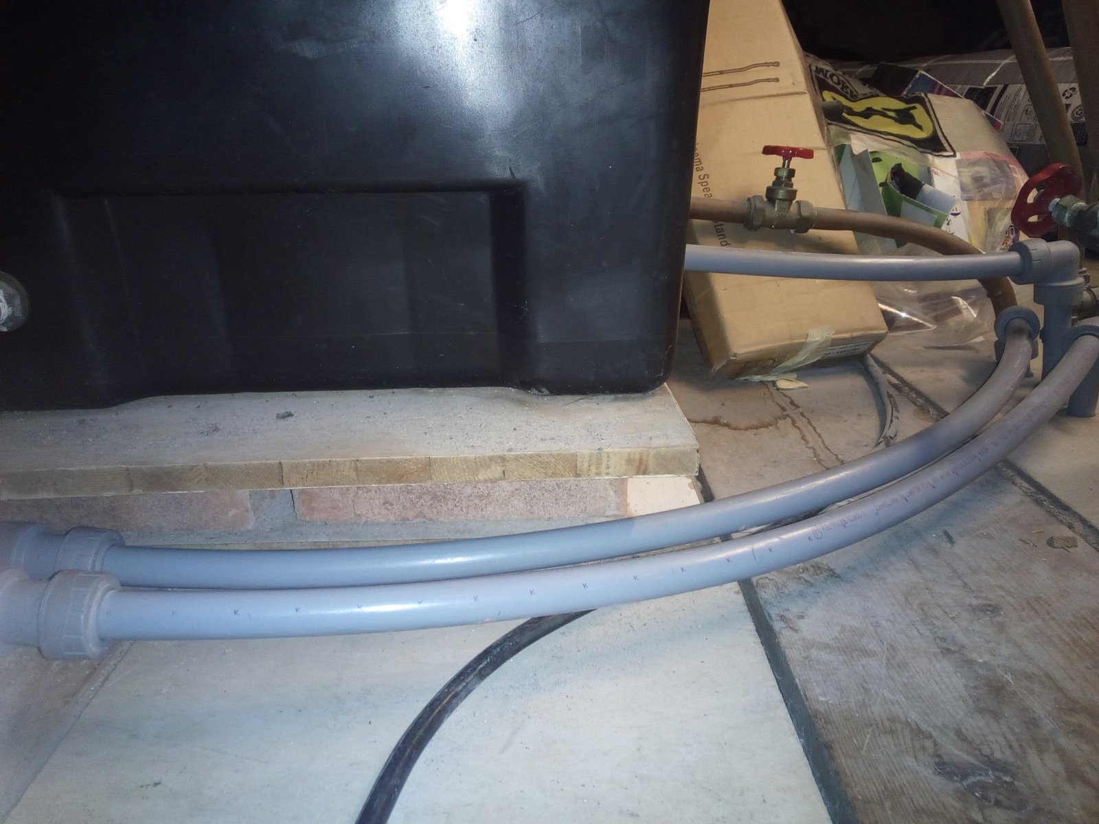

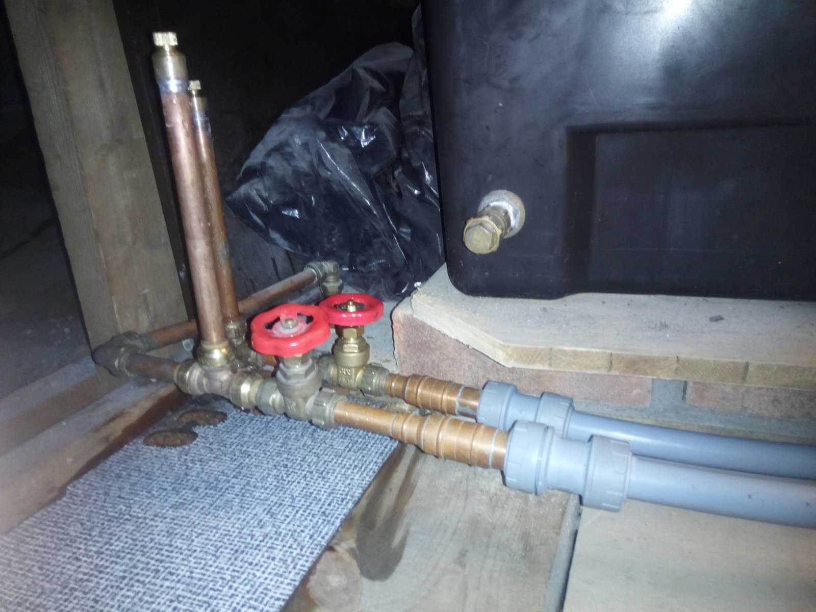

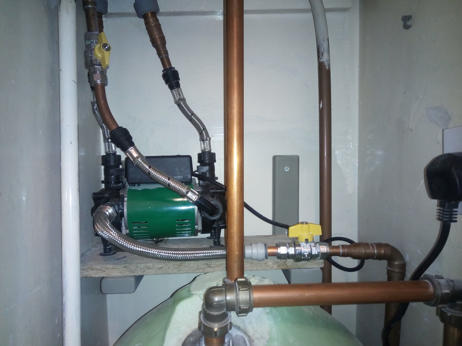

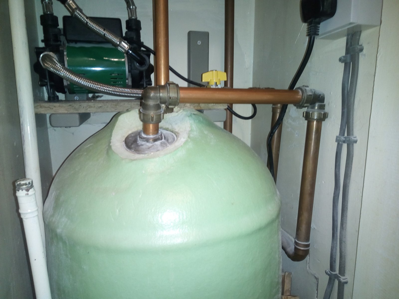

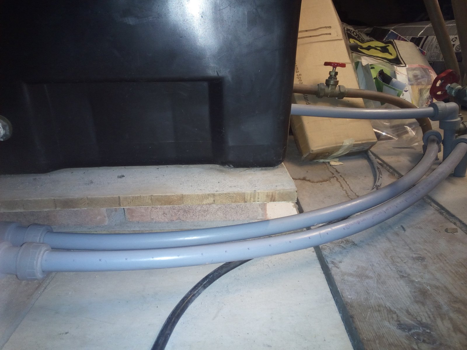

Some pictures of the pump, it's connections and the loft pipework. Are there any glaring errors? The grey plastic pipe out of the water tank goes directly to the pump below. It then comes back to the loft along the floor and reduces to 15mm. Before going down to the shower. The other grey pipe in the loft is from the hot side of the pump and does the same thing, reducing, etc.
IMG_20181227_194331.jpg IMG_20181227_194318.jpg .IMG_20181227_194053.jpg IMG_20181227_194038.jpg

Your hot water supply is the problem here, the thermo valve when opened starts with mostly hot to first and then starts to add cold as the hot supply heats up until up to temp. If there isn't enough flow at that point, from the shower head, then it won't start the pump.
The only thing that's changed here is the shower itself, so that's where your problem lies. If you had a bar mixer before chances are it was a thermo too but we'll never know. No or faulty NRV's can allow the pump to drain back to the cylinder when another hot outlet is opened but they can restrict the flow a little too as @steve32 mentions, removing them may allow the flow to increase enough but could also exacerbate the air issue in the hot supply, which is what you are suffering from.
