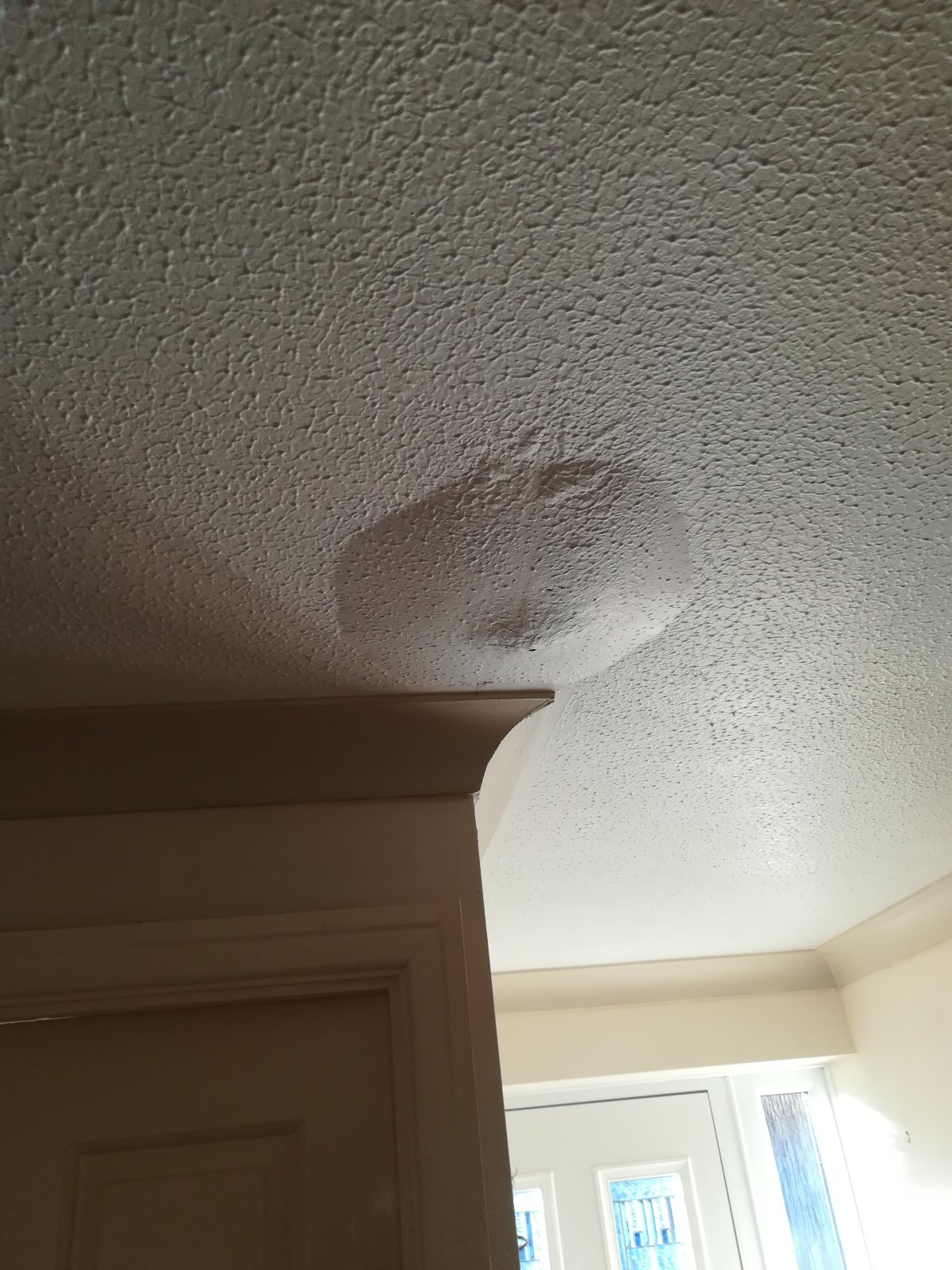

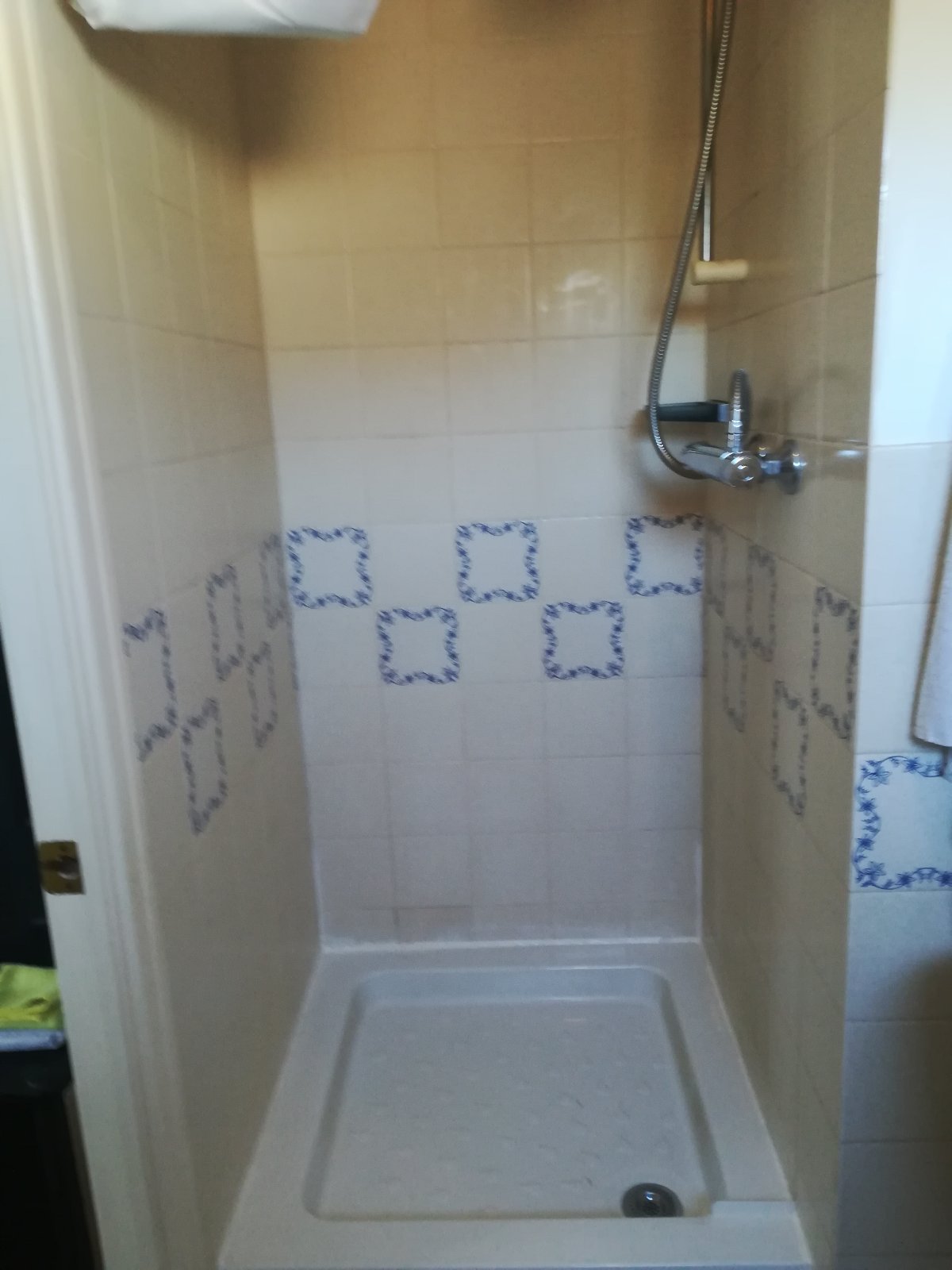

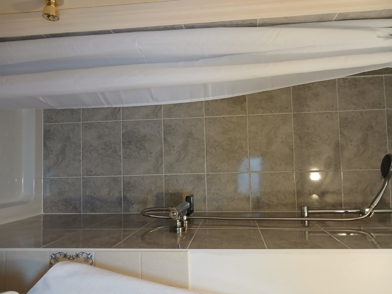

For a while, when I was trying to work out if there was a leak, we had a temporary shower curtain on three sides of the alcove so that spray didn't go on the tiles or tray sealant (the curtain rail is out of sight on the photo) . At this point I wasn't even certain there was a leak as the mark on the ceiling looked like a an edge of the boarding. No sign of any leakage. We took the temporary curtain down as it was in the way. A few months later we had the leak.
The shower spray itself has still been in use for hair washing over the adjacent washbasin with no problems, therefore it isn't the supply water plumbing. I've directed water down the waste and no sign of any leaks underneath. So the only thing left is the tiling.
Yes, we moved in here 43 years ago from new and we had various plumbing-related issues right from the beginning and the standard of plumbing was clearly poor in all these houses. For instance, some neighbours had water overflowing from the shower tray when they emptied the bath ! Bear in mind that apart from gaps in the grouting, some of the tiles are cracked. Most of the sanitary ware has now been upgraded and replaced except for the shower !

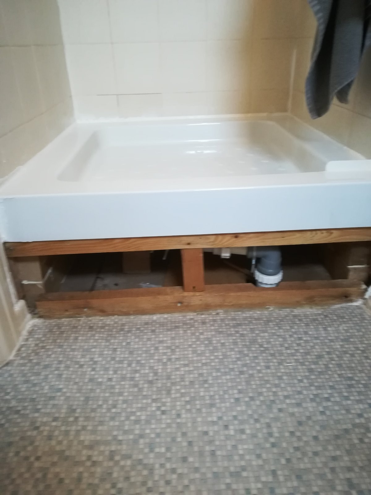

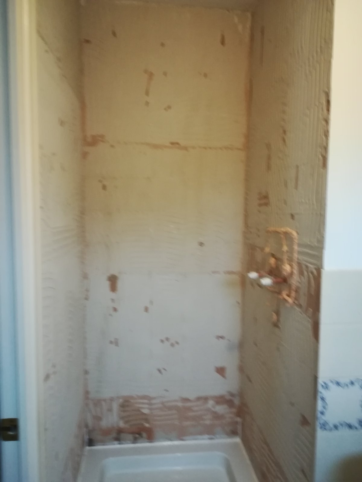

More evidence of the source of the leak that I haven't mentioned -
Immediately after it happened, after removing the front panel, I examined the underside of the tray with a torch and I could see water at the back of the tray, on the wall and on the timber supports at the back, directly below where the worn tiling and grout is worst. No evidence of leaks from the waste pipe near the front or anywhere else.
When showering, the back wall inevitably got heavily sprayed, a practice which I, at least, tried to avoid once we thought there might be a problem.
Obviously, the additional shower curtain around two sides of the shower recess that I mentioned earlier would have reduced or aleviated the problem but it was a temporary solution anyway and quite inconvenient. When pointed out, it was apparent that some tiles were coming loose it was so bad. Probably wasn't done properly by the builder in the first place, might have lasted another 40 years if it had been.
Fortunately, we do have a bath in another room. I am thinking of putting a second shower over the bath as a back up!

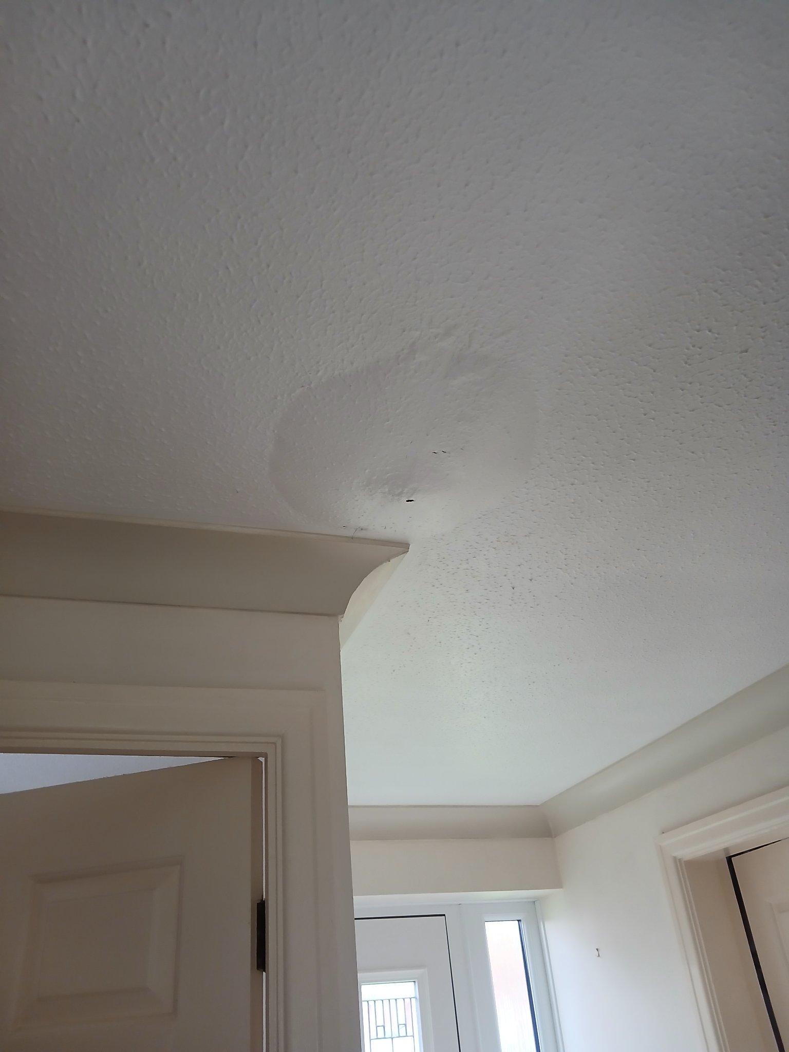

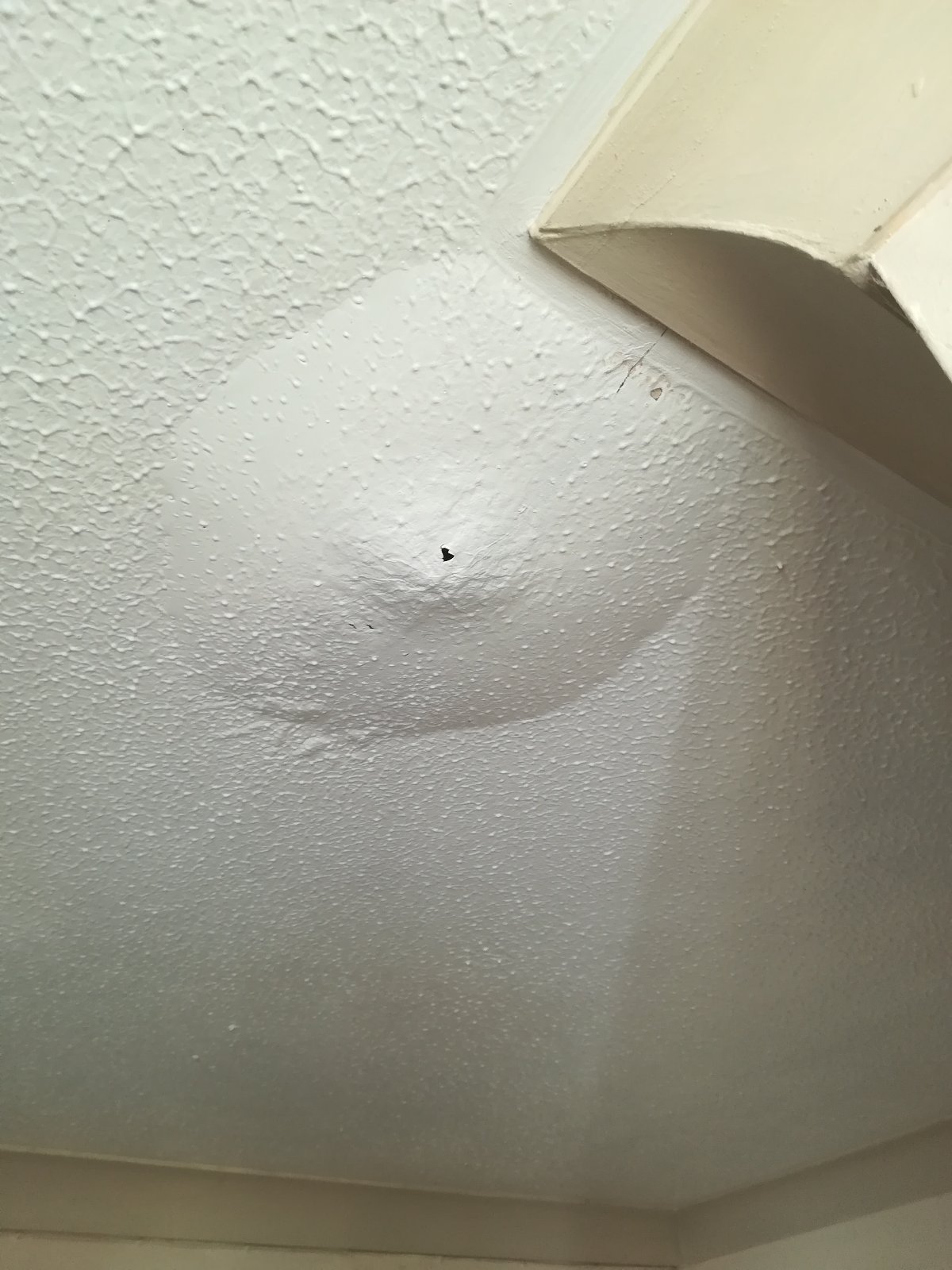

I've just had exactly the same problem. Grout had gone in a recess in a wall in the shower, water got behind the tiles and leaked through into the kitchen ceiling.

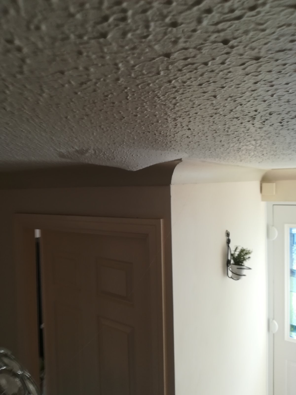

In our case, it had been seeping through just a little over a long period, gradually wearing the grout away, running along the ceiling boards below until a chance prolonged direct spray on the worst area caused it to break through below.
You can just see the worst in the attached picture along the bottom row of tiles at the back where there is actually a gap and the tiles are discoloured.

Time to pull it all out and start again. In my experience, once water is behind the tiles, and if it's a 1980's house most likely tiled on to plasterboard, it'll be soggy and soft.
My process, that I've used a few times, is to have some 18mm ply under the shower to help stop flex, cement board tile backer in the wet areas. Tank the whole lot using https://www.cwberry.com/dunlop-shower-waterproofing-kit-for-wetrooms-and-showers-4kg, seal the tray to the tanking first, then tile down to the tray.
Thanks for the advice. That's pretty well what is is being done. It is indeed a 1980's house and I bet your right, it's direct on to plaster board. It's been more than three months since the disaster and I purposely left the front panel off to allow air to circulate so hopefully it's dried out a bit. I will know soon.
Seems to me that relying on just tiles and grout alone in a shower area , however waterproof it is supposed to be, is just not adequate for a surface constantly sprayed with hot water. Fine for other surfaces which are just splashbacks etc.

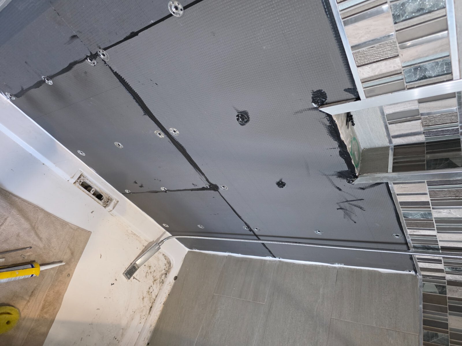

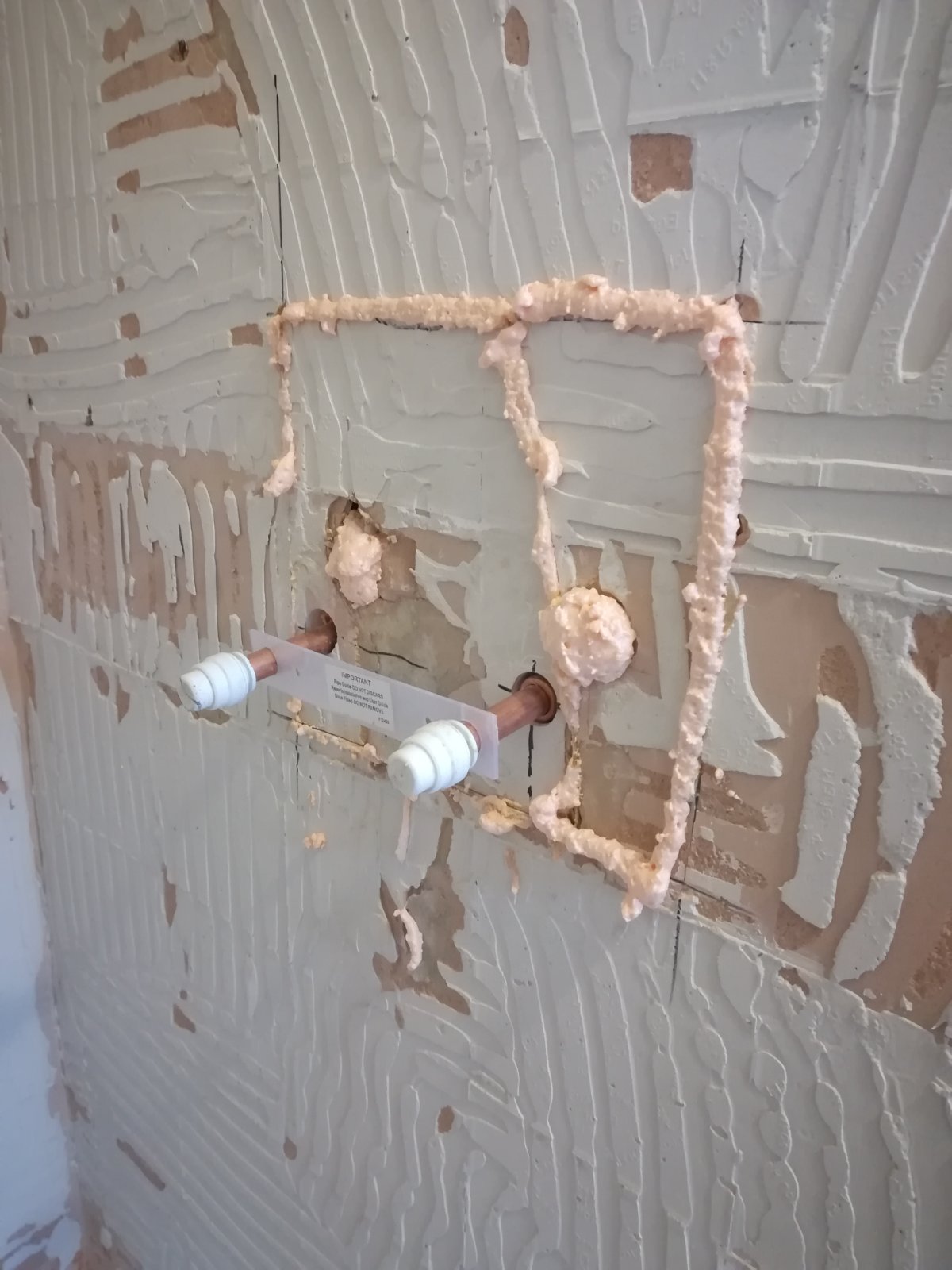

Shower cubicle retiled and finished. After old tiles were stripped off, there was evidence of water penetration visible even after 3 months of drying out ( see earlier photo). Photo of work in progress and of finished job to a high standard attached. Tray is double sealed as silicon was applied before and after new tiles were fixed in place.
Bathroom specialist plumber says if tiling and grouting is done properly, no further sealing should be necessary unless it is damaged or cracked. Resealing is only needed once temporary sealing has been done on damaged tiles or grouting.
No leaks so far after several trials.

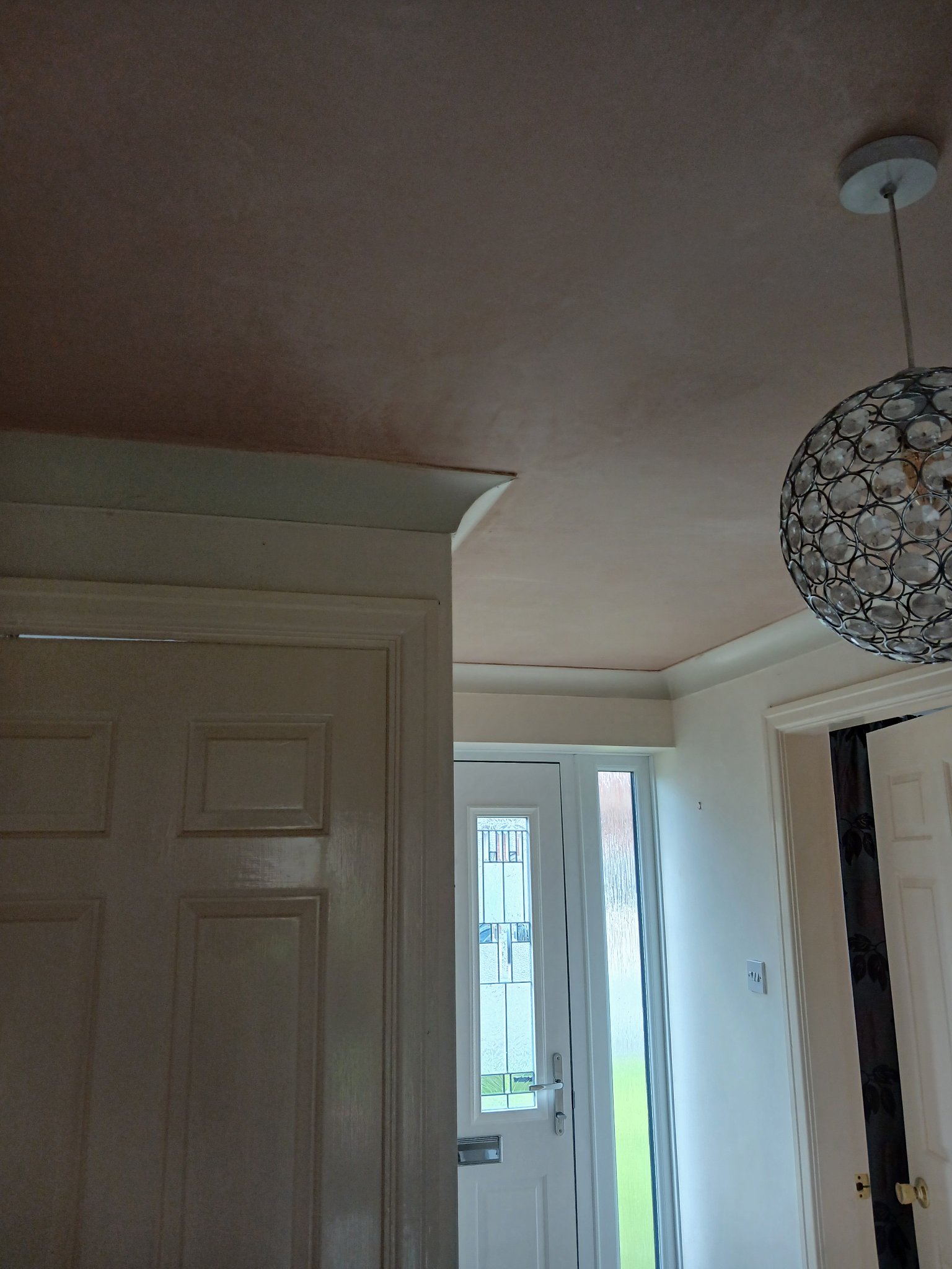

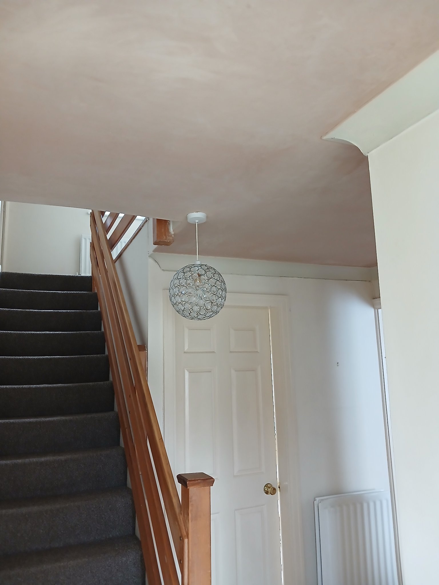

Last phase and trickiest in the aftermath of this disaster now pretty much completed. Artex ceiling damage has now been repaired and whole ceiling re skimmed. I didn't see the repair myself as we kept well out of the way while it was done owing to the asbestos risk. The plasterer said that he thought he would have to cut a holeout of the board and insert a patch. However, he said that the water had actually come through a joint in the boarding which hung down only a little. Therefore he was able to secure (nail/ screw I'm not sure which) the boards back against the joist before skimming the whole ceiling. He said that just a patch over the damage would always be visible. He did a good job very quickly with minimum mess.
See photos. I'm relieved it's done. Just a painting job for me now.
