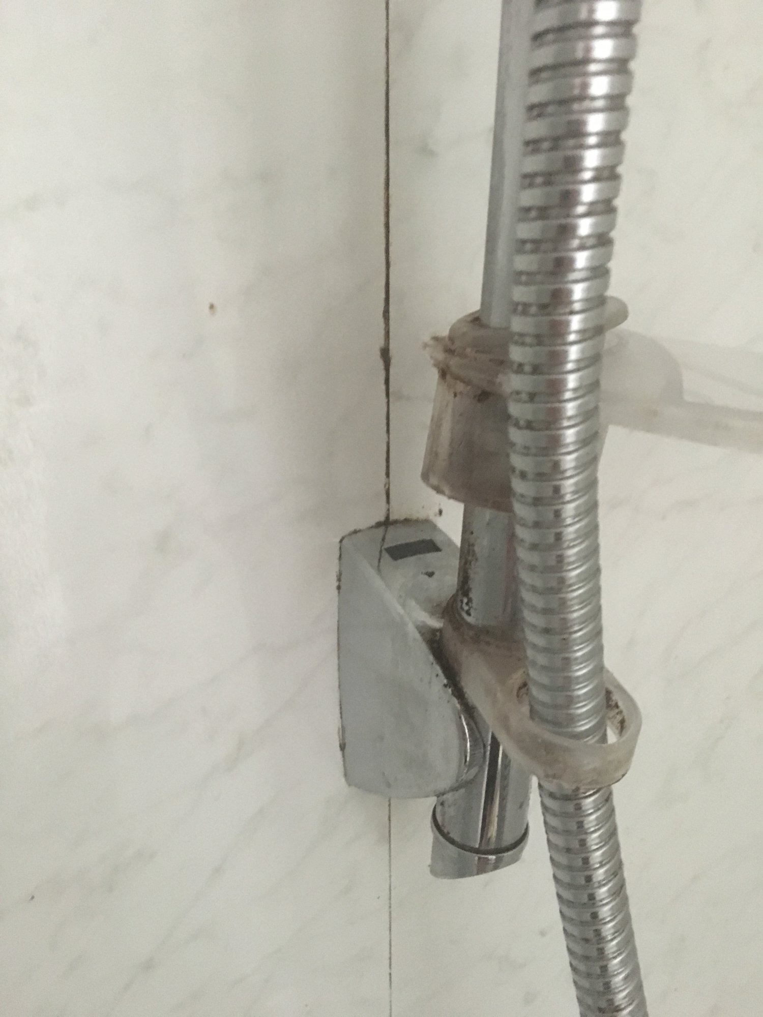

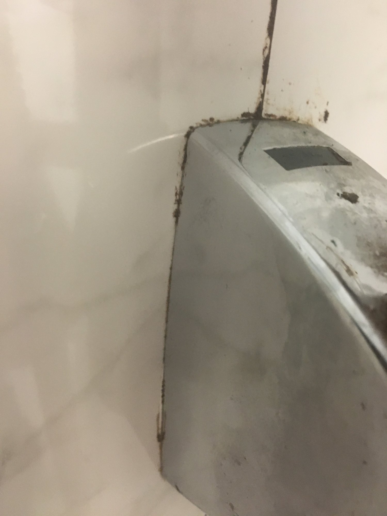

Hi I have just moved in and the shower head riser is broken . No matter what i try I can’t work out how to remove it . Can anyone point me in the right direction please
To remove the riser rail, somewhere the top and bottom fixing will be screwed to the wall, the screws are normally out of sight under a small prise out cover.
I would say that the top narrow section will pop off with a screwdriver as a lever to reveal the screw.
