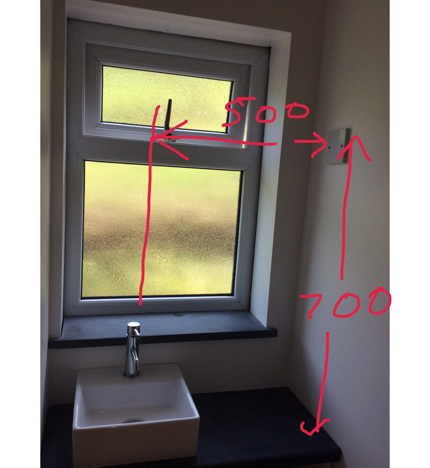

3EAB31AF-B992-4A5C-B6EC-A1AD60E1DCCA.jpeg Hi, I have taken out an extractor mounted in the window glass and wondered if I could utilise the old supply socket backbox to fit a switch to operate the ceiling mouted fan?
I dont like pull switches so are there any safe switches I could use in this situation?
The shower is 2m away at the opposite end of the room.
thanks

Yes. The basin distance is irrelevant.
Nothing to do with the regulations but is it the most convenient place for the fan switch?
It will presumably be needed when the shower is on and not when using the basin.
Would next to the light switch not be a better place?
Thanks for your reply,at the moment there is a switch outside the shower room door in the bedroom that operates the lights and fan .
I would like to run the light and fan indipendantly which is my reason for the question.
WhenI skimmed the wall I left the backbox and fitted a cover plate to show there was a live cable in the wall which isn't where one would expect one to be.

The location of the switch does not affect what it does - EFLI's point was is where you want to put it a sensible location?
If you were starting from scratch with a room with no electrical wiring, would you choose to put the fan switch there?
Also, what circuit was the old fan on, and how was it controlled?
It was powered from a fused down spur off a 15amp curcuit to the outlet on the wall and a pull cord on the extractor

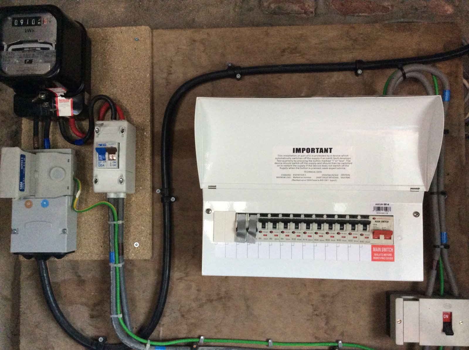

Is the circuit RCD protected?

I am not concerned about original supplies etc If one looks again at the op it should be clear that I only want to use the backbox to mount a switch to operate the new fan which is at present switched from outside the room.
Btw, curcuits are proected,RCbo housed in metal box

Indeed, but the question about RCD protection is vital to that, because if the circuit did not have it then you would not be allowed to do what you planned.
Also, the question about where the cable from the switch to the fan would run cannot be ignored (assuming you intend to bury it).
Finally, as you want a switch, it might be that you could use the FCU for that function.
Was going to blank original wiring from floor to box inside it with crimp blanking caps .
When I plaster boarded the wall I put a plastic conduit and cable from the loft to backbox just in case but now I know I can fit a switch I can run the wire into the junction box replacing the cable that goes to the switch outside shower room door .
I could use an fcu as a switch but would it be required as there is already an isolation switch in the loft near the inline fan .

Sorry - can't follow that.
The issue is whether any buried cables will be in the allowable zones:
https://www.diynot.com/wiki/electrics:walls
It's nothing to do with whether it's required.
You want a switch for the fan. The FCU could be that switch.
