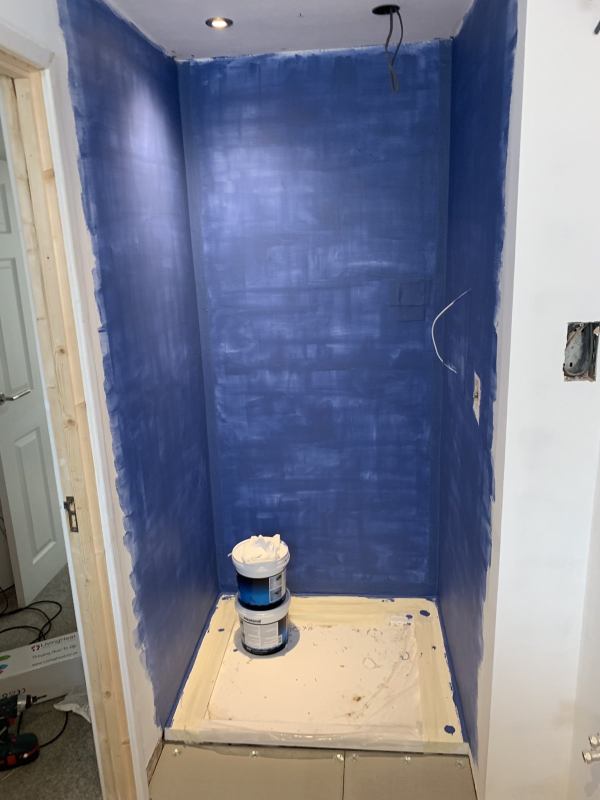

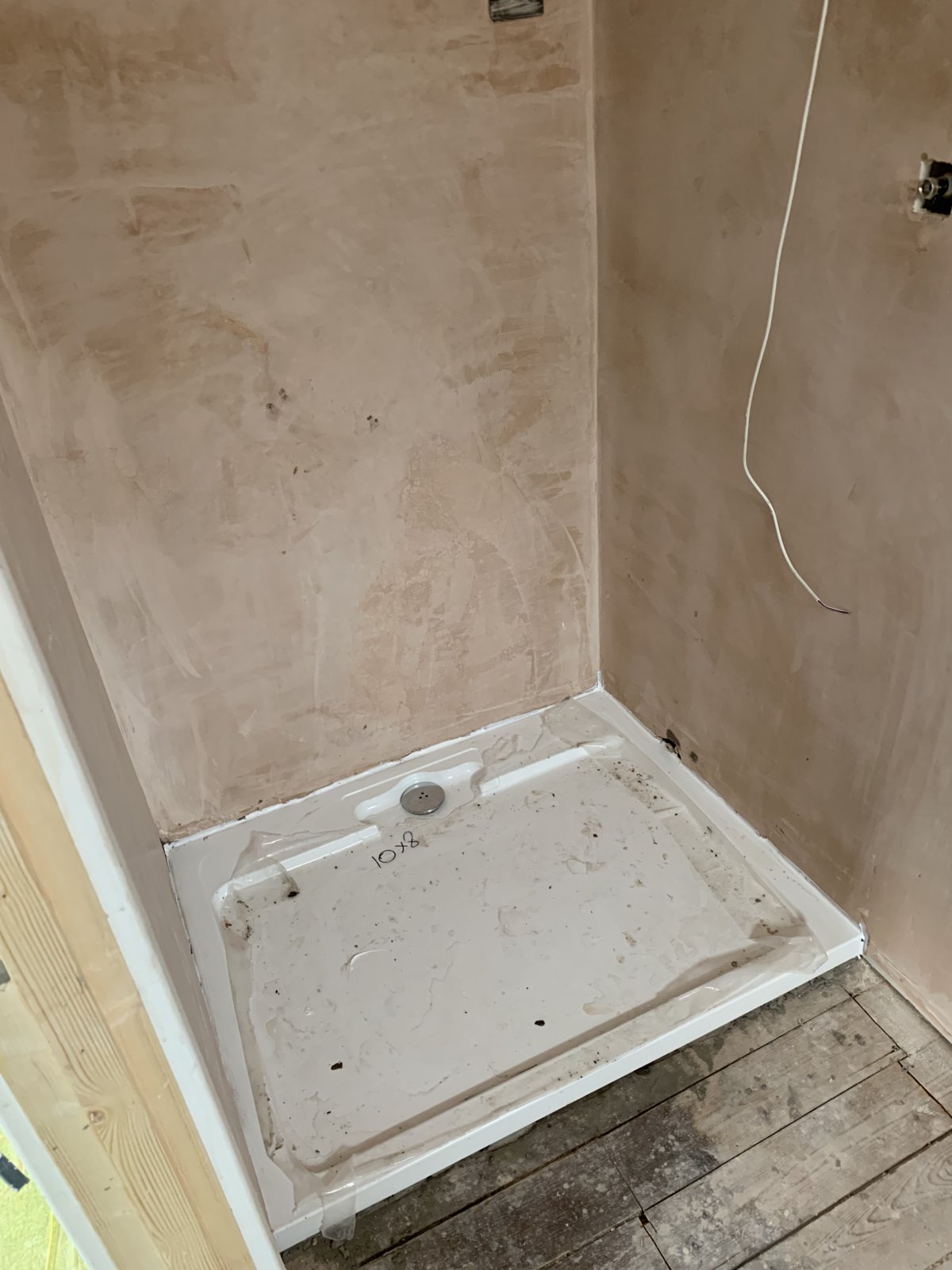

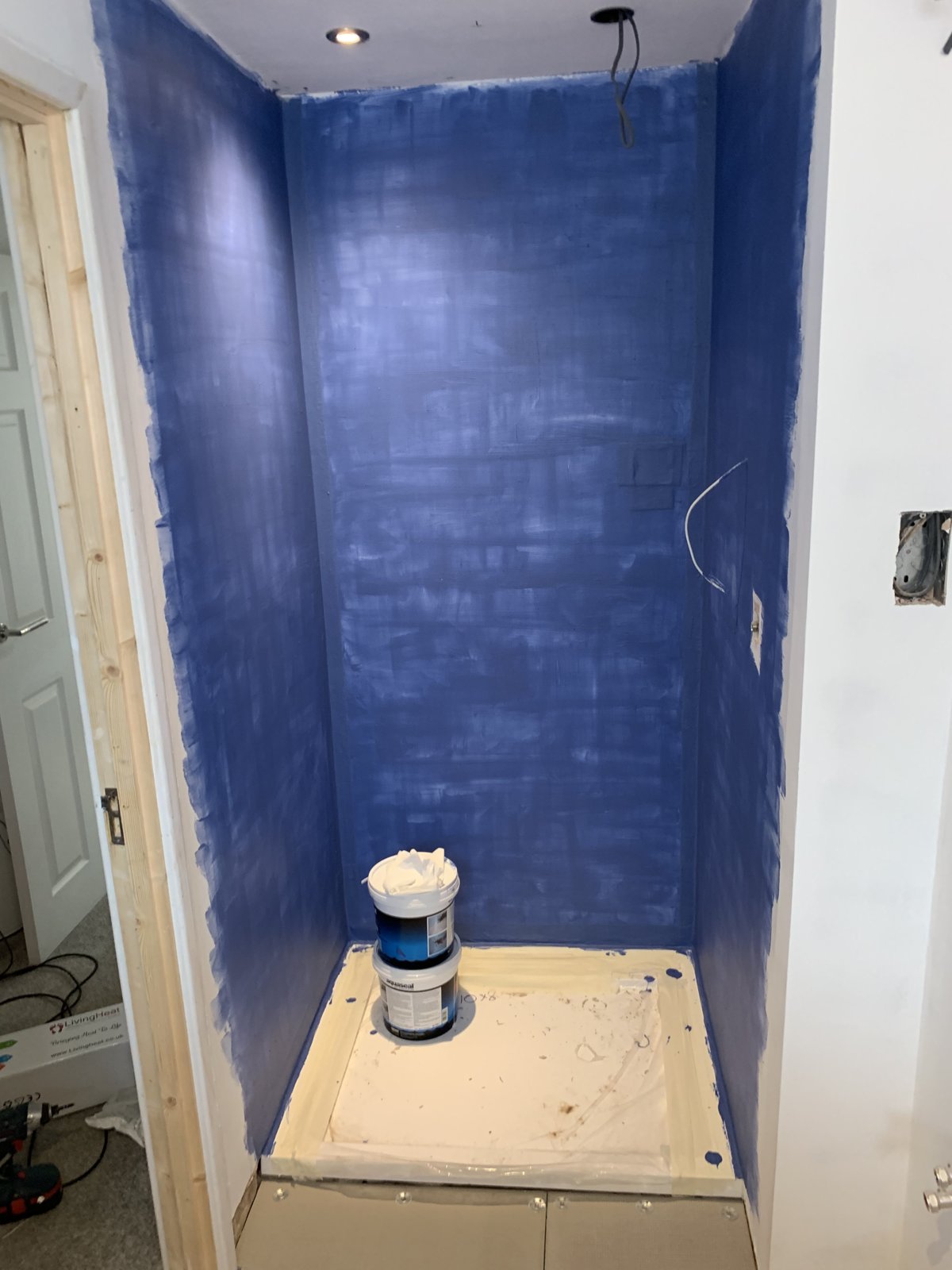

We’ve had a plumber install a shower tray a few months ago whilst having an extension and remodel etc, it’s a low profile type bedded onto the floorboards using mortar or tile adhesive. I’ve since tanked the walls (from bottom to top) and the tiler has been in today and tiled the 3 walls around the tray. When he’d finished he said it had taken longer than expected as something isn’t level, I’ve since checked the shower tray which is an 800x1000mm and over the width it is about 15mm out of level. Is this something I should be concerned about? The tiler is back tomorrow to tile the floor!
If the tray needs adjusting this will mean the tanking will be ruined as it’ll mean the bottom row of tiles will have to come off and the tanking won’t be installed correctly as in the bottom section would be installed over the top section which is the wrong way to do it.
If all this needs to be done then who is liable for the cost to put it right (tiles, tiler, tanking etc.)
Would it be best to hold off the tiler until it’s resolved or will being 15mm out be ok?
Hope someone can give me some advice!
Can you post pics ?
Is the tray within 3 walls ,with just the front open ?
This shows the location of the shower tray, it has 3 wall around it, it’s the left side that’s 15mm too low.

Maybe the pic is deceiving ,but it doesn't look that far out. You stated earlier that it does drain ,although it banks ( I assume to the left) somewhat. Have you done a trial fit of the door / frame ?
Taking all apart would be a right ballache , irrespective of who is to blame ,not to mention the additional costs .
Got to be worth doing a trial fit of the door / frame ,to see exactly what gap there is. It may not be as bad as 15 mm and you may be able to seal it. Especially if the tray does drain under full flow.
It’s the floor that’s out, I’ve had a straight edge across the full width of the tray and it’s definitely at least 15mm out. Will be trying the door later today, is a sliding type with the door on the left so not sure how it’ll sit.
The tiler doesn’t seem too fazed about removing tiles (might need a box of tiles) and doesn’t see any of it being an issue, I’ll speak to him later and find out what’s what.
@Salmon81 sorry to say it but if that tray has been plonked straight on to the floorboards or if there's anything less than 18mm WDP ply under it then you need to lift it.
It will never be level and over time I can just about guarantee it move and burst the seal at the wall/tile edge. I'd also be looking under the floor boards and putting in dwangs to span the joist gaps where the tray will sit so the tray if fully supported.
