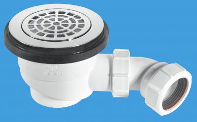

I have bought the MacAlpine ST90CP10-70 shower trap, see photos, because it is rated as a good one. I didn't want to use the free one supplied with the tray which looked flimsy and already had the thread crossed.

Never liked them shower trays where the waste outlet is in the tray entrance area,have to remember its a weak spot and it will be walked on a lot, there is no support under the trap. Waste connection in the opposite corner yes.
Also consider the raised domed mushroom cover could not be designed for standing on and feel uncomfortable under foot. I prefer these mcalpine outlet/traps.

> Waste trap - Swapping the waste trap for the one that Old&Bold suggests.
I can't see it on the McAlpine site if it is their's? Can you please give a model number etc, who sells it?
The one I have came from Screwfix, it can go back. I had been to plumbing merchants first, but they were more expensive even with trade discount, replying "Suppose I can order one mate, but it'll take a week" ???

This is available from Screwfix, https://www.screwfix.com/p/floplast-shower-trap-chrome-40mm/16391 should be ok to swap with what you have. If you prefer the McAlpine, try an independent Plumbers Merchants, the chains tend to be expensive for the DIY'er.
I would still be referring to the manufacturers instructions for installing the tray, failing to comply with these, and the tray fail during the guarantee period, I highly suspect they'll refuse any claim under the guarantee if the tray hasn't been installed as per their instructions. It may be designed to allow some slight movement, preventing that movement by adding support when not required could do more harm than good.
As an aside, how many other appliances are connected to that waste pipe? Showers ideally need a dedicated waste, right through to the stack or gulley.
Thanks, that is the same trap that I already have but the top cover is flat and chromed brass instead of the domed one I have. I will try a merchant for it, Screwfix don't have that exact one.

Not so keen on the Floplast, a few low star reviews on it, but thanks. I will try to track down the McAlpine suggested by Old&Bold.

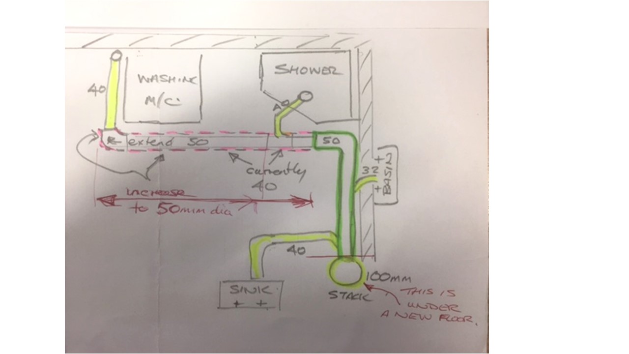

However, I have access to the 50mm and the two 40mm's currently meet at a branch in the existing 40mm run, which then later goes into the 50mm and from there out to the 100mm underfloor stack.
>> Proposal - see sketch, I could replace that 40mm part so the washing m/c and shower each join into a shared 50mm close to each of them.
In fact the washing m/c could run almost entirely in 50mm as the main 'artery'. The 40mm shower feed would meet the 50mm much further down the run, much closer to the 100mm final outlet.
See photo of sketch if it helps .
40mm run from washing machine should be ok on the initial run, upsize to 50mm at the tee where the shower couples in, although you may have to look at measures to prevent the washing machine siphoning the shower trap! What length is this run too? Should really ensure compliance with regs.

Waste system design - see updated sketch with dimensions. What do you suggest I do? From the run lengths seen in the sketch should I continue with it as drawn, i.e. extend the 50mm to just beyond the shower and then continue to the washing m/c in 40mm, with / anti-syphon / non-return valve?
