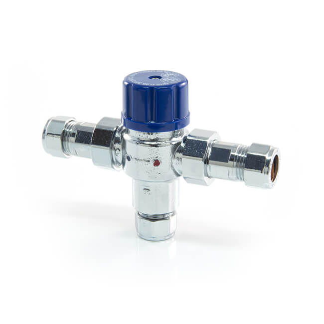

Probably is a thermostatic mixing valve, although usually just for baths. Looks something like this:

The thermostatic valve may need to be adjusted ,to increase the hot temperature range ,or it may be just kaput !!
Yeah a few people think it will be the valve. Just the only problem I have is I have no clue where it is lol.. all my plumbers are busy till new year so will have to wait if I can’t find it myself
I am referring to the actual shower valve itself ,not a separate blending valve like one pictured earlier. There would be absolutely no point whatsoever in having one linked to your thermostatic Kartell valve.
