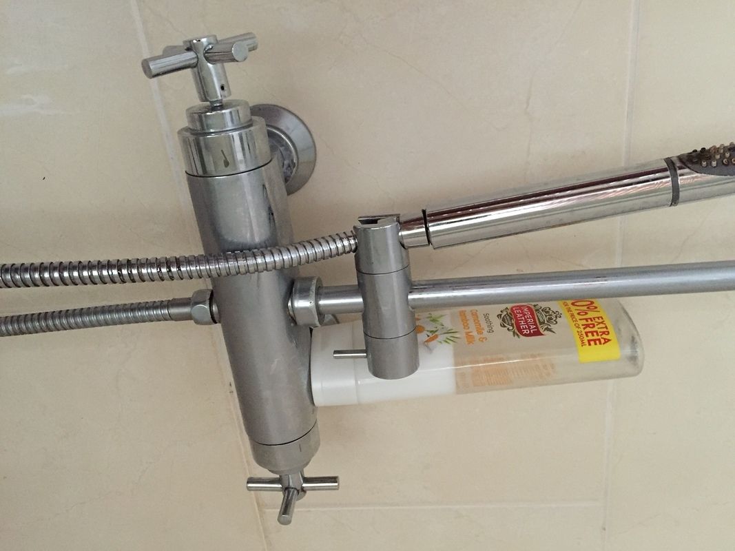

Hi,
The on/off tap on my shower valve has become very tight. You can hear and feel creaking when it is turned on and off.
Is it possible to strip this type of valve and make any repairs?
Cheers
Suts
Thanks prentice boy.
managed to strip it down and the inside was very rough, almost volcanic. Not sure if this is "limescale" of not but it certainly doesnt help the movement of the plastic parts inside.
Think i,m just going to get a new mixer.
Are the centers normaly a standard distance on a bar mixer?
